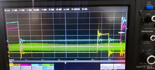

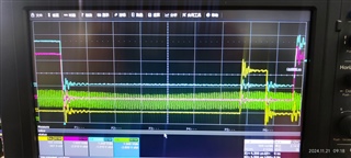

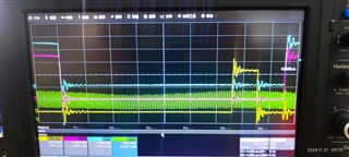

(Compared with the normal display on the large screen, TI needs to explain whether the DSI->TI941->TI948 and DSI->TI941->TI926 signal paths have different requirements for DSI (DSI CLK/DSI DATA))
2. The LT7911D DSI output is configured in non-homologous mode
The repeated flash screen measurement confirms that DSI CLK in non-homologous mode is around 81MHz.
In homologous mode, DSI CLK frequency is about 83MHz,
TI needs to confirm that DSI CLK is around 81MHz.
TI941 collects why the screen flashes,
If pixclk is restored based on the DSI clock,
DSI clock bias affects recovery pixclk frequency resulting in different frame rates,
But should not cause the screen fixed flash screen;

  • Hi Honle,
    • Can you share the video of the flash observation?
    • Does this issue happen when using patgen? Or only when using DSI inputs? I would recommend the following steps with PATGEN through ALP for video control/timing source to see the issue:
    • Sharing reg dump is helpful in narrowing down what factor to issue. If you don't have access to read the full reg dump, please try to read and share the contents of the following indirect registers of the 941AS:

  • Hi Honle,
    1. The reg dump of 941AS you shared that indicates DSI_ERROR and DPHY_ERROR (0xC [6], [5]) as below. To further investigation, please provide indirect page reg dump of the 941AS or some contents of indirect registers that was already mentioned above.
    2. Does issue ever happen when the 941AS uses patgen as steps below?
      1. Internal - Internal timing source / Internal PCLK
      2. Internal timing source / External PCLK
      3. External - External timing source / External PCLK
    3. Please share the init script if possible.
    4. Do you have access to a DSI protocol analyzer? It may be helpful for us to look at the DSI source/packet structure/order coming into the 941AS.
    Josh

    5. When there was a malfunction, the oscilloscope captured the timing sequence from 926 to LCD (clk, de, hs, and red [7]), and the oscilloscope displayed that all signals were shaking
    The display is a red image, and the oscilloscope is in DE falling edge trigger mode
    Yellow (hs) Green (clk) Red (Red [7]) Blue (DE)
