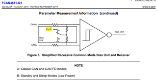

    The device uses the 5V LDO to create the 2.5V bias voltage for the CAN signals.  Bypassing this LDO with a 5.2V source will also have impacts to the CAN bus voltage levels.  Guaranteed current limits in a fault condition would also be bypassed and there could be large current flow through the external 5.2V supply.
