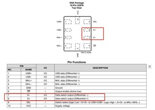

Dear TI Engineer,
We have question about the circuit design about the TS3USB3000.
1) Did the pin7 can connected to D-, and the pin8 connected to D+?
2) Also can the corresponding USB+and USB -, MHL+and MHL - also be connected in reverse?
Kind Regards
  • Hi Lumina,
    The D+ pin connects to MHL+/USB+, and D- connect to MHL-/USB-. Pin 7 should carry the D- lines of the USB2 data lines, and pin 8 should carry the D+ lines.
    We recommend keeping the positive lanes on the positive pins, and the negative lanes on the negative pins.
    Please let me know if you have any other questions.
    Ryan
