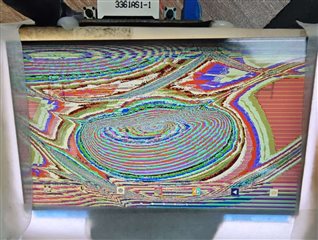

  • How should I configure which registers? 1920*1080 is the image output, and the clock frequency is 142MHz-158MHz. Can you help me configure the specific registers
  • At present, according to the configuration in the figure, the screen can be displayed, but there is a flower screen, can you help to see is the register configuration cause flower screen? Checked the hardware and found no problems. Thank you

  • 1、Our project is to input MIPI to LVDS output 1920*1080. Through the example of output internal color bar chart provided by you, the color bar chart can be output normally after testing.1920*1080 is the image output, and the clock frequency is 142MHz-158MHz;
    2、The above is my configuration of the 941 register, through the above configuration, the output screen appears flower screen;
    3、In order to be able to output 1920*1080 video normally, how should I configure, please guide me, more eager,thank you!

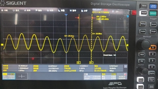

  • 5、with fDSI = 492 MHz, 4 DSI data lanes, and DSI reference clock mode, the output video PCLK rate would be 148.5 MHz,
  • I will wait for your feedback, At present, I have no clue to deal with this problem, thank you !
    Thanks for this information, we will need this for a later step in the debug.

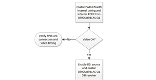

    For the time being we can now proceed with the flow diagram now that PATGEN from SER is successful (from DS90UB941AS-Q1 DSI Bringup Guide):
    The next script will confirm if the clock is correct and using internal timing (data lanes are not applied).

    While the DSI source is enabled, it will only be providing clock in this scenario, as options of External Clock Source is enabled and Timing is generated and configured internally.
    Please let me know the results of this test, and we may proceed with understanding where the phenomenon is occurring from.

    The PGTSC was not carried over from the previous write as 0x21 - this is corrected (but has no effect, as auto scrolling is disabled).
    Since the DSI configuration is not disturbed in this setup, please try this sequence:
    This comes from 941 power up sequencing, the suggestion here is to apply the DSI input before initializing with the code above to see if the output will appear. In this way, we can rule out whether the DSI clock is part of the issue in this configuration.
    If that does not work, we will need to evaluate the DSI input further based on this portion of the debug flow diagram (DS90UB941AS-Q1 DSI Bringup Guide):
    In the case the new code and sequencing is unsuccessful, we may try to evaluate the DSI configurations and continuous clock by checking this section:
    I have linked this guide above as well, please let me know if you need any further details testing this.
    If the code and sequence works, we can try the next step which is to use the same code but with external timing input:

  • I configured the register of 941 to output the screen of 1920*1080 through the 948 unstring chip. At present, the screen always appears and the register read through the address of the 948 unstring reader always returns STATUS_I2C_RECEIVED_NACK, but the color bar chart can be displayed through the configuration of 941
  • 1、I configured the register of 941 to output the screen of 1920*1080 through the 948 unstring chip. At present, the screen always appears and the register read through the address of the 948 unstring reader always returns STATUS_I2C_RECEIVED_NACK, but the color bar chart can be displayed through the configuration of 941.
    2、948 is set to 0V and R2 is set to 10kΩ. According to the specifications, IDx should be 0x2C. However, I directly connected the MCU to the i2c interface of 948 to read the register of 0xF3 using the address 0x2C, and the return value was STATUS_I2C_RECEIVED_NACK. Using IDx as 0x0C to read the register of 0xF3 does return a successfully readable value, what is the reason? Normal 948 address should be 0x2C, checked the hardware can not find the reason

  • 5、The color bar map is displayed normally, and the screen output appears on the flower screen. There is a register script in front of it that provides the display effect and the specific configuration of 941
    Allow me to look into this further, it appears that the mode select strap setting for the 941 does not match the following configuration below?
    4、4 Number of DSI channels
    5、DSI rate (Mbps): 290Mbps
    Mode 0 in this case would be 1 lane, but 4 DSI channels are being used here.

  • 1、We have one DSI0 input, two link output, four data channels
    2、Address = 0x4F DSI channel select 1, the screen is not displayed, select 4, the screen is displayed only flower screen
    3、I use an NXP S32K144 chip, which uses a 7-bit address
    I see,
    Four data channels and dual (two) FPD-Link configuration, you may need MODE_SEL0 = Mode No. 3

    1. Are you able to provide waveforms to certify the incoming clock and data to the RX is meeting 941AS specifications?

  • 2、Are you able to provide waveforms to certify the incoming clock and data to the RX is meeting 941AS specifications?
    This is the waveform of the 941 RX,
    MIPI-CKN to GND test
    3、The comparison diagram displayed on the 1920*1080 display after stringing through 941/948 is as follows. The graph displayed after stringing through is stretched horizontally and vertically with different regular deformations

    Thank you very much for providing all the additional information about the system.
    The DSI frequency reported in the oscilloscope capture appears to be around 505.35 MHz,
     fDSI = 492 MHz
    One of these must be incorrect? I believe the data rate to frequency conversion is a multiple of two, so for a data rate of 290 Mbps = approximately 580 MHz DSI clock frequency.
    fPCLK = (fDSI*NLANES)/12
    PCLK = 193.33 MHz
    If this is the case, the UB948 has a PCLK limitation of 192 MHz in dual-link configuration on the FPD-Link RX side, so this may not work.
    For the DSI frequency that is shown in the oscilloscope capture, this would be a calculation of
    PCLK = 168.45 MHz
    This is fine, but for this configuration T_SKIP is a different number
    With 505.35 MHz / 252.675 Mbps DSI data rate
    TSKIP_CNT = Round(65*fDSI - 5)
    = 28

    What is the configuration that allows the screen to produce normal (original drawing)?
    Miguel
  • 1、Using 505.35 MHz and 580 MHz calculated values board.WriteI2C(serAddr, 0x42, 0x38) and board.WriteI2C(serAddr, 0x42, 0x42), the effect is still the same, the screen is still displayede
    2、What is the configuration that allows the screen to produce normal (original drawing)?
    The question is to compare the effect of the dot plot I made on the computer and the result displayed on the 1920*1080 screen through the serializer output
