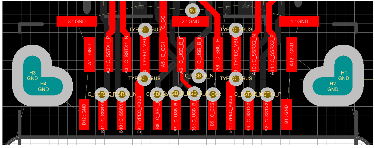

Step 1: Get the latest footprint symbol from your Type-C connector vendor and double check it. And check it again. In the ideal case, working with your board manufacturing partner to verify the footprint and planarity of the connector. When you build for volume, a small percentage of failures will quickly come to haunt you. A test-build could also save money down the road to work out any issues that may come up. Below is the footprint for the connector used on our TPS6598x BoosterPacks.
Step 2: Once you found a home for your connector, get started on placing vias. From some previous test builds we have found that it is best to use through-hole 8/16 mil vias (no blind and buried vias). As far as design rules, we are setting our difference net spacing to 3 mil (worst case) and tenting our vias (top/bottom). Make sure the via hole does not hit the pads on the Type-C connector to avoid “via on pad”. Check the via placement on the connector below. This connector shorts the Top/Bottom USB2 pins.

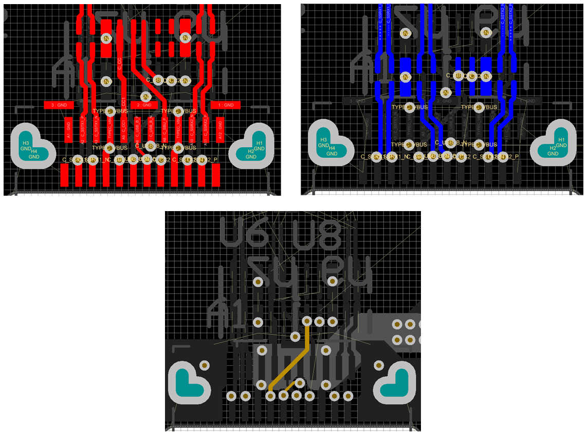

Step 3: Get those SSTX/RX pairs out on the top and bottom layer. Since these are the most crucial signals, make sure they get out cleanly to reduce the amount of “serpent” bends you have to do to match their lengths. Refer to you board’s designs rules for proper differential impedance.
Step 4: The SBU, USB2, and CC1/2 pins are next to be routed. Check out the TPS65982 datasheet for the widths for CC1/2 and refer to you board’s designs rules for proper differential impedance.  The
The figure below show the SSTX/RX pairs, USB2, CC1/2, and SBU routing on the top/midlayer/bottom/ layers.
