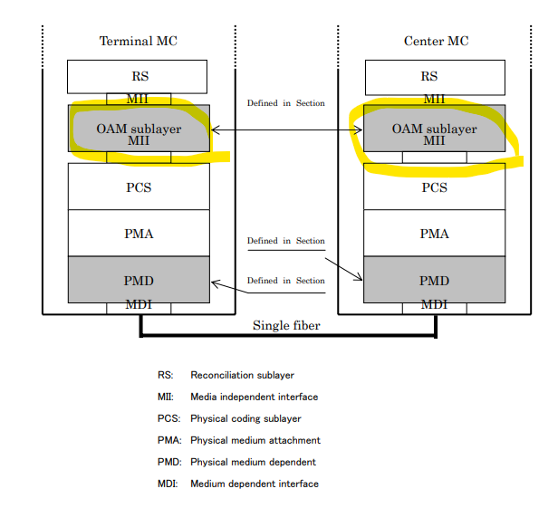

Part Number: DP83849I
Dear experts,
Dear experts,
Hello Ryo,
The DP83849I does not support Fiber Ethernet or the 100Base-FX standard, so it would not support the TTC TS-1000 standard.
Justin
Hello Justin-san,
Thank you for your reply.
I understand DP83849I would not support that standard.
Do you think DP83849IF can support it?
I would appreciate if you would give me comment.
Thanks and best regards,
Ryo Akashi
Hello Ryo,
I cannot find documentation that DP83849IF supports TTC TS-1000. Do you have an example of a PHY that supports the standard? The block diagram provided with the OAM sublayer MII makes me wonder if the standard required an intergrated MAC PHY?
