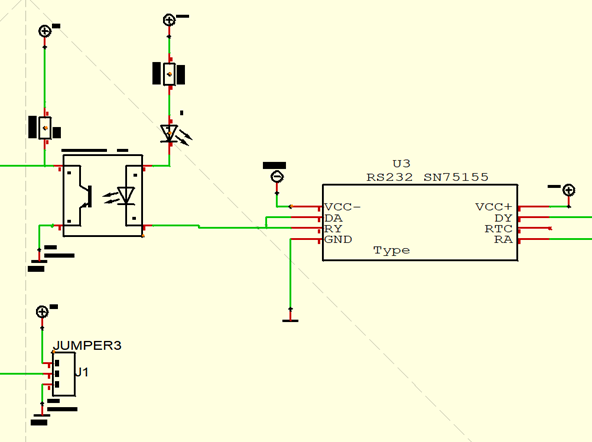

Schematic 1: RS232 Transceiver SN75155

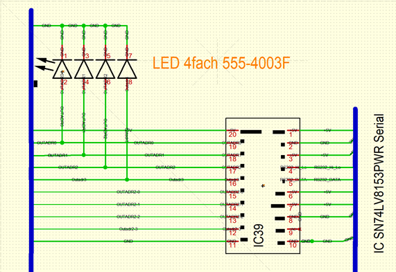

Schematic 2: SN74LV8153 :

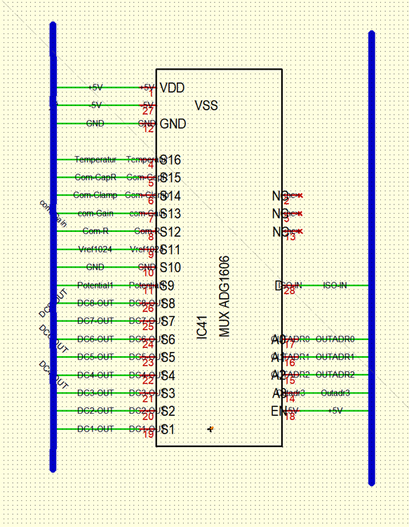

Schematic 3: One of two MUX ADG 1606 Inputs A0 to A3
Load is
Y0 to Y3 quad 5 V LED 5mA against ground and Adressline A0 to A4 of MUX ADG1606
Y4 to Y7 Adressline A0 to A4 of a second MUX ADG1606
Today I had to replace again four of the SN74LV8153. The SN74LV8153 Inputs Ax, Outsel, Reset and OE are directly connected to ground and +5 VCC. Latch up and / or power up problems?
