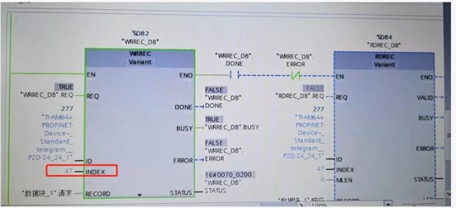

      3.In the PN_RT_MII Example,  We did not see any read-write request and response operation functions in the RealIdentification.c, and if we want to implement the acyclic data communication as below, how to modify the code in the current SDK? Thanks!

  • Dear Dhaval,
           If you have an S7-1211 controller on your side, can you have a try to add this module(Like the WRREC and RDREC ) as below:
          Can we have a try and study this function? Thanks!

  • Dear Dhaval,
             The WRREC and RDREC module cannot be implemented on LP-AM243 device. In fact, the settings of the two modules are for the acyclic data communication. When customer use this module, it reports response timed out from the TIA Portal V16.

  • Dear Dhaval,
             Those two modules (WRREC and RDREC module) I have mentioned earlier, it implements the Record data-CR, not the Alarm-CR.
             And what the customer wants to implement is the functionality I marked in red below picture:
             In fact, I didn't find a path to achieve this functionality. So could you continue to find the implemented path?Thanks!

  • Shaoxing
    Please review the following APIs for read/write record:
    For reference, in the SDK example, one of this APIs is used in "APP_configDev()" function of appStackConfigure.c.
