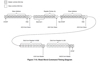

Hi there
I would like to read a register from the TI temperature sensor TMP117 with my microcontroller. The picture below shows the desired behavior:
Here is my init()-function. As I see some behavior on the I2C-Lines, I guess it works.

With the following code i want to:
  1. Send the slave address
  2. Send the register pointer
  3. read two Bytes

The oscilloscope shows that only the WRITE part is executed. The clock is not working in the READ part. It looks like the READ part is ignored.
I have already tried different variants, but I can't get the values to be read in.
PS: The addresses in the example are not especially useful. As soon as the I2C interface works properly, I will add the code so that it drives the sensor correctly.

  • Dear Charles
    Thanks for your recommendation. I must have copied the wrong command. they look similar. Beside this the i2c address was 8 bit long instead of 7bits. I post the working code below in case someone else has a similar problem.
