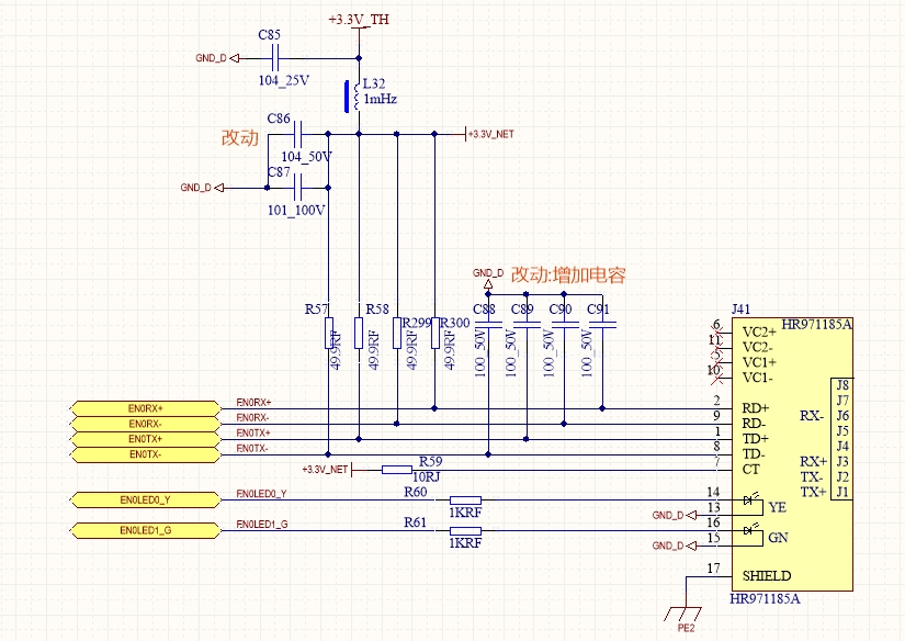

When using the Ethernet port of your IC: tm4c1294ncpdt-t3, it is found that 1. The 100m communication rate is not on the Ping of 100m network cable, and the communication can be achieved by using 10m network cable of the same length (100m). 2. During signal test, the rising edge and falling edge are too large (eye diagram test can pass).
Please help analyze:
1. The reason why 100m network cable communication is not available for 100m.
2. The rising and falling edges of the signal are too large. thank you!
remarks:
The attached figure is the wiring and schematic diagram (both impedance 100 and differential are processed.)

      - Looking at your schematic, I don't see a protection diode on the differential signals. I see you connect to RJ45 with an integrated transformer.  Protection diodes is quite important or risk damaging the chip. Please refer to the TM4C129 system design guideline for details. https://www.ti.com/lit/pdf/spma056
    - It will be easier to troubleshoot if you could do the same measurements on a EK-TM4C1294XL LaunchPad. What do you get? Please show your ping result on both the LaunchPad and your custom board.
    - Run Ethernet examples from TivaWare on both the LaunchPad and your custom board and then do your benchmarking again.

    Charles has the right idea to check the design guide, he posted snip of ETH0 schematic for reference.
    Perhaps remove C88, C89, C90, C91 to reduce TX/RX signal magnitude and roll-off. For R59 (CT) 100n would be more feasible placement in my opinion.

    These methods have been tested before. Similarly, a 100M network cable can communicate at 10Mbps, but not at 100Mbps. Please take a look.
  • but not at 100Mbps. Please take a look
    Yet where do you see 100nF caps on TX/RX differential pairs in TM4C129x design guide? Perhaps your schematic show 100pF (c88-c91) filter caps but even that seems odd too.
