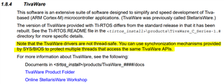

Is it correct to say, the standard DriverLib library from TivaWare is not thread safe. For this reason, a subset of drivers are provided within TI-RTOS-TivaC, which is thread safe. These are the drivers found within \ti\drivers, for example ti\drivers\UART.h?
    Your understanding is correct. TivaWare is not thread-safe but you can use synchronization to protect multiple threads that access the same TivaWare APIs.

    In terms of DriverLib, maybe the bundled version found within tirtos_tivac (C:\ti\tirtos_tivac_2_16_00_08\products\TivaWare_C_Series-2.1.1.71b\driverlib) is the one the developer should use, instead of reaching directly into C:\ti\tivaware?
    The underlying TivaWare version bundled with TI-RTOS version 2.16.0.18 is TivaWare version 2.1.1.71b. The reason is that 2.1.1.71b is the one that is fully validated. Newer versions of TivaWare can be used but they are not validated. You can go through the release note of the latest TivaWare version to know what changes have been made compared to prior versions.
    So in summary, when developing an application within TI-RTOS for the TM4C, which drivers are you allowed to use.
    If you are using TI-RTOS drivers, I will suggest you use the validated version for TI-RTOS which is 2.1.1.71b that is bundled with TI-RTOS.
    Should you only try to exclusively use the subset of RTOS drivers, or is it fine to directly use DriverLib drivers?
    If you are not going to use TI-RTOS drivers but rather TivaWare directly you can use the latest TivaWare version which is 2.2.0.295. Please use the necessary synchronization to protect for thread-safety.
