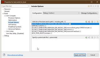

    Then include the SDK in your projects properties:
    Evan

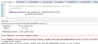

  • Evan,
    I'm making progress but still have a few issues getting this to work. It looks like most of these issues have to do with CCS not able to find things in my application.
    1. First it wasn't able to find cmdline.h or usb_structs.h so I found them and copied them into my project and that seemed to work.
    2. When I ran my application in Debug and tried setting a breakpoint at line 66 in usbhandler.c I got the following error message:
    No code is associated with
    "C:\TI\simplelink_msp432e4_sdk_4_20_00_12\source\ti\usblib\msp432e4\device\usbhandler.c", line 66 in any loaded symbols
    3. It looks like there a bunch of commands from line 1543 to line 1629 in usb_dec_cserial.c that are configuring the usb port in the usbdevcserial example so I started copying some of them into my application. Here is one of them:
    USBDCompositeInit(0, &g_sCompDevice, DESCRIPTOR_DATA_SIZE, g_pucDescriptorData);
    I was able to get it to find the parameters so it compiled ok, but the linker said it couldn't find USBDCompositeInit.
    Thank you for any help you can provide to get me past these issues.

  • Brad,
    Seems like you have an older version of the compiler. I'm using CCS v11.1.0.00011. Can you make sure you have the latest CCS and simplelink installation?
    I was able to build a project with all the imports from usbdevcserial with these steps:
    Adding the simplelink SDK:
    Adding the following include paths:
    Evan

  • Brad,
    What happens when you select v20 in your build settings and then try to import the simplelink sdk? As an example:
  • Evan,
    I selected v20 as you suggested and now I am able to import the simplelink sdk successfully.  Whew!
    But, the linker still isn't able to find USBDCompositInit() which is in usbdcomp.c and usbdcomp.h is in one of the #include statements I put in earlier.  Here is the error message I'm getting:
    All of the includes you suggested earlier are also active:
    I tried a few things, but wasn't able to get past this.
    Do you have any suggestions on how I can diagnose why the linker can't find USBDCompositInit()?
    Brad
