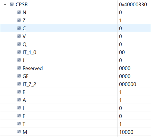

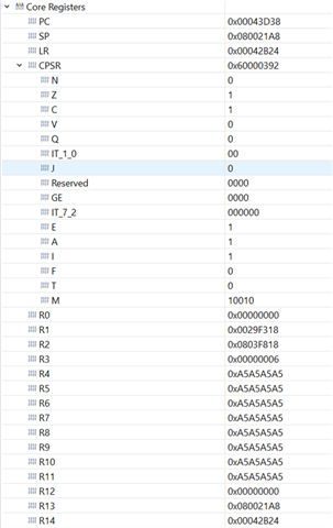

I am currently working on a project and in this project we are using the compile flag "--code_state=16" to compile the project for THUMB instructions. I am running in to an issue where I am entering an IRQ, and upon entering this IRQ the T bit in the CPSR register gets switched from 1 to 0 (THUMB to ARM), but the instructions within this IRQ are still THUMB instructions. Upon executing one of the THUMB instructions (a movs instruction) within the IRQ I get an Undefined Instruction Hard Fault. I am unsure as to whether this is due to trying to execute a THUMB instruction while in ARM mode or if it is because of something else. I have attached an image of the state of the core registers before executing the instruction that causes a hard fault & after the instruction that causes the hard fault. I have also attached a picture of the disassembly of the C code to show exactly what instruction is causing the issue. Any pointers on how to resolve this issue would be greatly appreciated.

    In addition to this, the pictures I attached in my first post are both in the IRQ. The one labeled "Before" is before executing the instruction that causes the UNDEF, "After" is after executing the instruction that causes the UNDEF. I have attached new pictures to show the state of the CPSR register before entrance of the IRQ & after entrance of the IRQ. As you can see, before entering the IRQ I am in THUMB mode, after entering the IRQ I am in ARM mode.
    Before Entering IRQ:
    After entering IRQ:
  • As you can see, before entering the IRQ I am in THUMB mode, after entering the IRQ I am in ARM mode.
    From a quick-look at Exception entry and exit summary and c1, System Control Register in the Cortex-R5 and Cortex-R5F Technical Reference Manual r1p1, on exception entry:
    The T bit is set based on the state of the TE bit in the SCTLR
    Has your program set the TE bit in the SCTLR, or left it at the reset value?
    Where the reset TE bit value is configured by the primary input TEINIT, which I think TI have strapped to give a reset value so that exceptions are taken in ARM mode.
    While the TE bit in the SCTLR isn't marked as read-only, if changed it will affect all exceptions until the next reset, which I think means you can mix-and-match different exceptions as ARM or THUMB mode.
