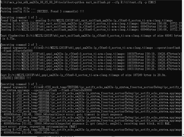

   Customer meet problem when use python script to program flash. They use customized flash on LP-AM263x.  They always get failure if image size is larger than 320KB. I checked sbl_uar_uniflash project, the buffer to receive file is much larger than 320KB. as
#define BOOTLOADER_UNIFLASH_MAX_FILE_SIZE (0x1C0000)
From the log provided by customer, it looks like device fail to receive application images.
Can you please help to exam the messages from python script?
Q1. is there anyway/document we can use CCS to debug sbl_uart_uniflash so we can get more clear insight of the issue?
Q2. What will make xmodem transaction fail? Anyway to make python script to provide more information to help debug?

    (mcu+) andre@elevation:~/ti/mcu_plus_sdk_am263x_08_05_00_24/tools/boot$ python uart_uniflash.py -p /dev/ttyACM0 --cfg=/home/andre/ti/mcu_plus_sdk_am263x_08_05_00_24/tools/boot/app_config/gpio_led_blink_r5f0-0_am263x-lp.cfg
    Parsing config file ...
    Parsing config file ... SUCCESS. Found 3 command(s) !!!
    Executing command 1 of 3 ...
    Found flash writer ... sending /home/andre/workspace_v12/sitara_mcu/am263x/sbl_uart_uniflash_am263x-lp_r5fss0-0_nortos_ti-arm-clang/Debug/sbl_uart_uniflash_am263x-lp_r5fss0-0_nortos_ti-arm-clang.tiimage
    Sending /home/andre/workspace_v12/sitara_mcu/am263x/sbl_uart_uniflash_am263x-lp_r5fss0-0_nortos_ti-arm-clang/Debug/sbl_uSending /home/andre/workspace_v12/sitara_mcu/am263x/sbl_uart_uniflash_am263x-lp_r5fss0-0_nortos_ti-arm-clang/Debug/sbl_uSending /home/andre/workspace_v12/sitara_mcu/am263x/sbl_uart_uniflash_am263x-lp_r5fss0-0_nortos_ti-arm-clang/Debug/sbl_u                                                                                                                        Sent flashwriter /home/andre/workspace_v12/sitara_mcu/am263x/sbl_uart_uniflash_am263x-lp_r5fss0-0_nortos_ti-arm-clang/Debug/sbl_uart_uniflash_am263x-lp_r5fss0-0_nortos_ti-arm-clang.tiimage of size 68433 bytes in 6.82s.
    Executing command 2 of 3 ...
    Command arguments : --file=/home/andre/workspace_v12/sitara_mcu/am263x/sbl_qspi_am263x-lp_r5fss0-0_nortos_ti-arm-clang/Debug/sbl_qspi_am263x-lp_r5fss0-0_nortos_ti-arm-clang.tiimage --operation=flash --flash-offset=0x0
    Sending /home/andre/workspace_v12/sitara_mcu/am263x/sbl_qspi_am263x-lp_r5fss0-0_nortos_ti-arm-clang/Debug/sbl_qspi_am263Sending /home/andre/workspace_v12/sitara_mcu/am263x/sbl_qspi_am263x-lp_r5fss0-0_nortos_ti-arm-clang/Debug/sbl_qspi_am263Sending /home/andre/workspace_v12/sitara_mcu/am263x/sbl_qspi_am263x-lp_r5fss0-0_nortos_ti-arm-clang/Debug/sbl_qspi_am263Sending /home/andre/workspace_v12/sitara_mcu/am263x/sbl_qspi_am263x-lp_r5fss0-0_nortos_ti-arm-clang/Debug/sbl_qspi_am263Sending /home/andre/workspace_v12/sitara_mcu/am263x/sbl_qspi_am263x-lp_r5fss0-0_nortos_ti-arm-clang/Debug/sbl_qspi_am263                                                                                                                        Sent /home/andre/workspace_v12/sitara_mcu/am263x/sbl_qspi_am263x-lp_r5fss0-0_nortos_ti-arm-clang/Debug/sbl_qspi_am263x-lp_r5fss0-0_nortos_ti-arm-clang.tiimage of size 187249 bytes in 18.62s.
    [STATUS] SUCCESS !!!
    Executing command 3 of 3 ...
    Command arguments : --file=/home/andre/workspace_v12/sitara_mcu/am263x/gpio_led_blink_am263x-lp_r5fss0-0_nortos_ti-arm-clang/Debug/gpio_led_blink_am263x-lp_r5fss0-0_nortos_ti-arm-clang.appimage --operation=flash --flash-offset=0x80000
    Sending /home/andre/workspace_v12/sitara_mcu/am263x/gpio_led_blink_am263x-lp_r5fss0-0_nortos_ti-arm-clang/Debug/gpio_ledSending /home/andre/workspace_v12/sitara_mcu/am263x/gpio_led_blink_am263x-lp_r5fss0-0_nortos_ti-arm-clang/Debug/gpio_ledSending /home/andre/workspace_v12/sitara_mcu/am263x/gpio_led_blink_am263x-lp_r5fss0-0_nortos_ti-arm-clang/Debug/gpio_ledSending /home/andre/workspace_v12/sitara_mcu/am263x/gpio_led_blink_am263x-lp_r5fss0-0_nortos_ti-arm-clang/Debug/gpio_ledSending /home/andre/workspace_v12/sitara_mcu/am263x/gpio_led_blink_am263x-lp_r5fss0-0_nortos_ti-arm-clang/Debug/gpio_ledSending /home/andre/workspace_v12/sitara_mcu/am263x/gpio_led_blink_am263x-lp_r5fss0-0_nortos_ti-arm-clang/Debug/gpio_ledSending /home/andre/workspace_v12/sitara_mcu/am263x/gpio_led_blink_am263x-lp_r5fss0-0_nortos_ti-arm-clang/Debug/gpio_led_blink_am263x-lp_r5fss0-0_nortos_ti-arm-clang.appimage: 566981bytes [00:54, 11087.89bytes/s]recv error: getc timeout in start sequence
    Sending /home/andre/workspace_v12/sitara_mcu/am263x/gpio_led_blink_am263x-lp_r5fss0-0_nortos_ti-arm-clang/Debug/gpio_ledSending /home/andre/workspace_v12/sitara_mcu/am263x/gpio_led_blink_am263x-lp_r5fss0-0_nortos_ti-arm-clang/Debug/gpio_ledSending /home/andre/workspace_v12/sitara_mcu/am263x/gpio_led_blink_am263x-lp_r5fss0-0_nortos_ti-arm-clang/Debug/gpio_ledSending /home/andre/workspace_v12/sitara_mcu/am263x/gpio_led_blink_am263x-lp_r5fss0-0_nortos_ti-arm-clang/Debug/gpio_led_blink_am263x-lp_r5fss0-0_nortos_ti-arm-clang.appimage: 566983bytes [01:08, 294.71bytes/s]expected sequence 2, got (seq1=1, seq2=1), receiving next block, will NAK.
    recv error: purge, requesting retransmission (NAK)
    Can you please check if there is any issue in SBL_UART_UNIFLASH or python script?

  • With CCSDebug:
    sbl_uart_uniflash fail at the last step.
           status = Bootloader_xmodemTransmit(CONFIG_UART0, (uint8_t *)&respHeader, sizeof(Bootloader_UniflashResponseHeader));
    Bootloader_xmodemTransmit() doesn't transmit data.
    The respHeader parameters of Bootloader_xmodemTransmit() is captured as:
    Field team doesn't know the detail of uniflash communication protocol. Please check and provide solution. Customer is waiting for response.
    Andre
  • Hi ,
    I have replicated the issue. I have raised an internal ticket for the same (https://jira.itg.ti.com/browse/MCUSDK-9890). This link might not be accessible outside TI network.
    For certain images (approx. 550KB), I tried increasing the timeout number -
    in uart_uniflash.py of xmodem_send_receive_file function. It worked for me. The actual fix will be done by in 08.06 release itself.
    Also, I tested, even with this error, the image was correctly flashed so I request you to try the application boot in QSPI boot mode. But I agree, it should've ended gracefully which it isn't.
    Hope it helps.
    Aakash

     Confirm adding timeout value uart_python.py solve the problem. You can close this issue now. Thanks for your help.
