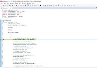

  • Hi LayEng,
    I would like to ask about the slave device address that I have to fill in. If the slave device is PCA9535, what is the slave address that I should set in i2cSetSlaveAdd(i2c, PCA9535_3_I2C_ADDR). Is PCA9535_3_I2C_ADDR = 0x20 or 0x40 assuming a2, a1, a0=0?
    We have to write 0x20 if a2,a1 and a0 are zero.
    This is because we should not give R/W bit to the address
    So, the binary value of slave address if the a2,a1 and a0 are zero is b(0100000) and its equivalent hex is 0x20.
    Thanks & regards,
    Jagadish.

  • Hi LayEng,
    I am attaching the code for your reference, please go through it.
    I2C_TEST_LC43.zip
    In this code, I am using trying to communicate with 3 slaves and if one slave is not available than i am checking whether second slave available or not and continued this operation.
    Verify and let me know if you have any doubts.
    Thanks & regards,
    Jagadish.

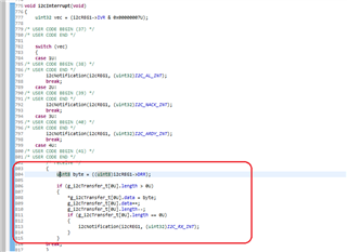

  • Hi LayEng,
    1. I notice that you didn't use interrurpt (eg nack interrupt) to check if there is nack. Instead you use polling. Is this better? It definitely breaks these 2 while loops :
    In this case either way is fine i.e. interrupt or polling. If you use interrupt method, you should set a flag if ACK is not received and using that flag you can break the while loops and you can go and try second slave. And polling method also fine because after i2c start it will immediately send address and if it doesn't receive ACK then it will immediately set the NACK flag and using that flag, we can break the while loops and can try other slaves.
    2. The only means to force the scl to go high is reset?
    I never tested any other ways, i felt it would be a easy way to reset the i2c to bring it back to the initial state.
    Is it a must to send data to an i2c device? Actually sending an address is enough to detect whether there is noack. I notice that you send data of 0x10 .
    No need to send the data, you can just send address its just fine. Actually, i took one already existing example where it is sending 0x10 data also and i modified that example to your requirement so you can leave that.
    Thanks & regards,
    Jagadish.

    sadd is max 16bits in specs. So the wrong type is used for sadd. I have passed an 8bit address to this function and found that the address registered in SAR is 0.
    It should not be possible,
    See here i am passing 0x57 value as address
    Now in debug you can see 0x57 at lower 7 bits of SAR register
    Thanks & regards,
    Jagadish.

  • Dear Jagadish
    Thank you very much for your lengthy reply. Before your reply, I was using interrupt and using the polling path to envision sw flow. So my understanding seems to be wrong. As I describe earlier, I enabled interrupt for tx, rx, stp, and nak. Using the receive example, I thought that when I use
     i2cReceive(i2c, length, RX_Data), I check for data receive using the while loop. I am wrong?
     Btw, I don't see  (uint32)I2C_RX_INT set in i2c->IMR. How is it set? Also if I use interrupt mode by enabling the interrupts in halcogen, I can't use i2cReceiveByte and i2cSendByte as they are not interrupt mode? Can polling mode routines be used in interrupt mode? Polling mode meaning you wait for the bit to be set, like stop bit, bb bit etc...
    There is another flaw in the polling design. When I check whether the ic is available or working, I use i2cReceive or i2cReceiveByte . If the IC is not available or non working, it will hit the while loop
    while ((i2c->STR & (uint32)I2C_TX_INT) == 0U)
    Is there anyway to check the presence or functioning of an i2c ic or functioning of the i2cinterrupt without getting stuck in a while loop?
    Thank you for your great support.
    I am very sorry for not clicking the checkbox for this resolved my issue. I am about to be at my last question. Thank you
  • This is how I set the i2c interrupt
