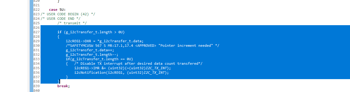

    This HalCoGen code you shared has an interesting implication.
    If I transmit a message of only 1 byte, I will never receive a I2C_TX_INT, which means prev_cmd will never be set to True.
    Without using polling, how can you tell if a transmission is done, if no interrupt is ever generated?

  • Hi Gabriel,
    Yes, you are right. There is a bug and please refer below workaround from QJ.
    (+) TMS570LS1115: I2C interrupt not working - Arm-based microcontrollers forum - Arm-based microcontrollers - TI E2E support forums
    Thanks & regards,
    Jagadish.

  • Yes, you are right. There is a bug and please refer below workaround from QJ.
    This is very helpful thank you!
    It seems like I have the same problem as @user5967417: the RX Interrupt works but not the TX Interrupt.
    When I put a breakpoint in the i2cInterrupt function I don't receive any TXRDY interrupt.

    In this thread, it looks like even with the modified code, the user can't receive TX ISR.
    Gabriel
  •  If you want I can create a separated thread, as we are entering a new subject: the HalCodeGen TX ISR problem.
  • please create a new thread. Its might not be good to combine everything thing in one issue.
