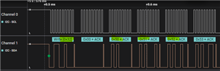

I have occasional I2C bus hanging due to arbitration loss after an "ungraceful" reset. How can I address this?
Before initiating any I2C communication, I call the Cdd_I2c_Init function. However, due to the design, it's impossible to call Cdd_I2c_DeInit before a "warm-start" reset.
I'm using the MCAL Version AM263x 08.06.02, and I'm utilizing the Cdd_I2c Driver included in that package.
As a workaround, I modified the startup sequence to run Cdd_I2c_Init, Cdd_I2c_DeInit, and then Cdd_I2c_Init again to reset the I2C peripheral. This approach has somewhat helped, but I'm still facing issues with the bus hanging. To address the remaining hanging issues, I set the CddI2cArbitrationLossParam variable to CDD_I2C_RECURRENT_MODE, aiming to send 9 clock pulses to the slave to synchronize the bus - but this hasn't been effective.
Of course, there might be issues with the target I'm communicating with, but do you have any suggestions on what I can do from the microcontroller side to resolve the I2C bus hanging, despite resetting the I2C peripheral and using CDD_I2C_RECURRENT_MODE?
Additionally, I'm using the I2C1 instance in polling mode and running the communication at a 100KHz bitrate.
Moreover, in Code Composer, I see the hang in Cdd_I2c_Polling_Mode_Receive, specifically in the while loop on line 509. The IsrStatus variable holds the value 400h.
Any suggestions for improving the implementation are most welcome.

  • Hi Mikael,
    I am sorry for late response. I did a test this morning using MCAL driver. I sent message to I2C slave (aardvark), but I didn't see the data on I2C1 bus. I am investigating if I2C1 is supported in the MCAL driver.
  • No worries about the late reply. Thank you for further testing and investigating the issue.
  • Hi Mikael,
    The I2C1 of MCAL driver works. I configured I2C to write data without slave attached, and probed the SCL/SDA pins on AM263x CC dock card. I got the correct clock signal, and data signal: slave address is 0x32, write mode.

  • I2C slave (0x32) received the data from AM263x I2C1. The I2C slave is total phase I2C adaptor:
    probed I2C signals
