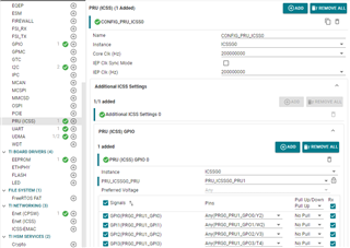

I am using mcu_plus_sdk_am243x_09_02_00_50 with EVM board. I need to get data from PRU1 to R5F0_0 and then sent the data to ENET_MAC_PORT_1 in R5F0_0, under noRTOS environment.
Thus, I try to understand the examples in mcu_plus_sdk_am243x_09_02_00_50:
example 1:\examples\pru_io\adc\ads85x8\am243x-evm\r5fss0-0_freertos
example 2:\examples\networking\enet_layer2_cpsw\am243x-evm\r5fss0-0_freertos
I modify the template to meet my requirement and I can successfully execute them separately, then I try to integrate them, and problems occurs.
To verify my suspicions, I just add "PRU(ICSS) GPIO" under "additional ICSS settings" in example 2, no other operations. Then, I cannot send and receive frame from PHY.
Please tell me why? Thanks.
I also see this, but I don't need to use Enet(ICSS), I use Enet(CPSW).

    I tried adding the PRU GPIOs to the enet_layer2_cpsw example, I am still able to send and receive frames from the CPSW port. Can you power reset the board and try again? With only the addition of PRU GPIO, I do not expect the example to fail.
    Nitika
  • When you integrate them, is the PRU -> R5F data transfer part working properly?
    Yes, it works well.
    If I add GPI0~GPI6, I am still able to send and receive frames from the CPSW port.
    If I add GPI0~GPI7, I cannot send and receive frames from the CPSW port.
    Can you also try to see if you have the same phenomenon?
    I do see the same phenomenon happening.
    The reason for that is the PRU GPO pins below from ICSSG0 are muxed with CPSW pins.
    When you select the above pins from PRU ICSS section, the CPSW pins change to any other available pins causing the example functionality to break.
    You will not be able to use the above 6 pins that are from PRU1 in your usecase.
    Now, based on this I would like to know if the use of ADS8588 is a necessary requirement for your project or you can look at other ADC implementation as well?
    Nitika
    In my case, I need to use GPI0~GPI15 (PRU_ICSSG0_PRU1) in total.
    In TI enet_layer2_cpsw example, RGMII1_IOSet_1 and RGMII2_IOSet_1 are used, when I try to disable RGMII2 and enable RGMII1_IOSet_2  in the example (without adding PRU_IO),  I cannot send and receive frames from the CPSW port as well, I'm confused about this, why this happen?
    I want to disable RGMII2 and enable RGMII1_IOSet_2 due to the PRU GPI pins from PRU_ICSSG0_PRU1 will not be muxed with CPSW pins in this way.

  • Hi Xiangju,
    Apologies for the delayed response, I was not available the last week.
    The dev team has reviewed the issue and they have suggested a working configuration for your use case - Utilising MAC port 2 and PRU GPIOs
    Please follow the steps below to implement that:
    1. From Enet (CPSW) > MAC Port Config, Select the 'Disable Mac Port 1' option under MAC Port 1 Config and deselect that option under MAC Port 2 Config
    2. Enable GPI0~GPI15 (PRU_ICSSG0_PRU1) from PRU (ICSS).
    3. From Enet (CPSW) > Pinmux config, Deselect the option 'Enable RGMII1 for CPSW'. The settings should resemble the one below:
    4. Modify the file l2_cpsw_main.c to use ENET_MAC_PORT_2 in the global variable testParams as below:
    /* Use this array to select the ports that will be used in the test */
    static EnetApp_TestParams testParams[] =
        { ENET_CPSW_3G,  0U, ENET_MAC_PORT_2 /*ENET_MAC_PORT_1*/, "cpsw-3g", },
    5. Save the configuration, re-build and test the example.
    I have tested this on my end and the functionality is working as expected.
    Nitika
