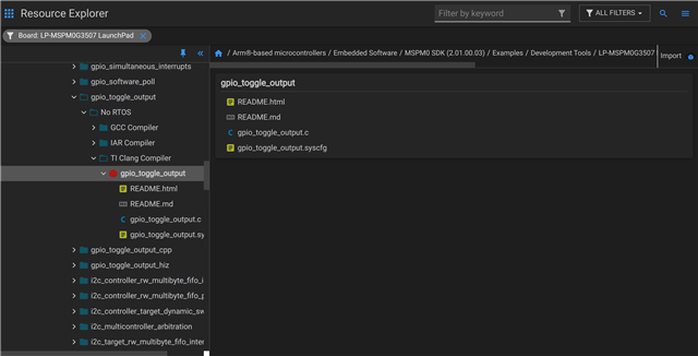

Importing the sample project as shown below:
![project](./img/project.png)

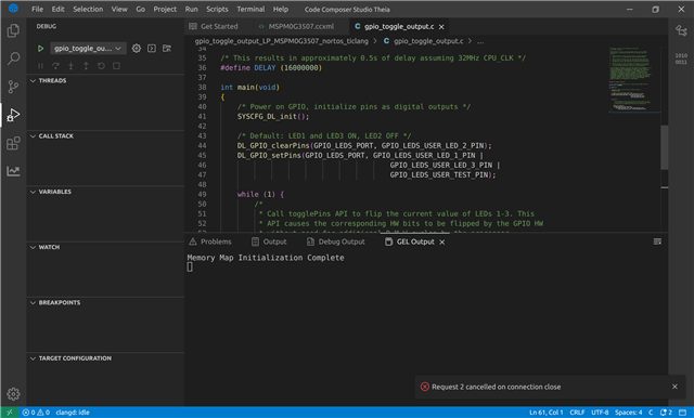

After clicking debug for the first time, it seems to program successfully, but debugging does not seem to run properly.
![problem0](./img/problem0.png)
Ending the debug session results in the error: `Request 2 cancelled on connection close`
![problem1](./img/problem1.png)

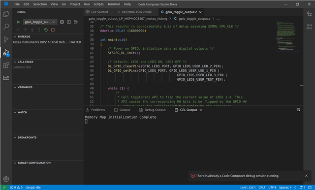

Clicking debug again produces the following error:
`There is already a Code Composer debug session running.`
![problem2](./img/problem2.png)

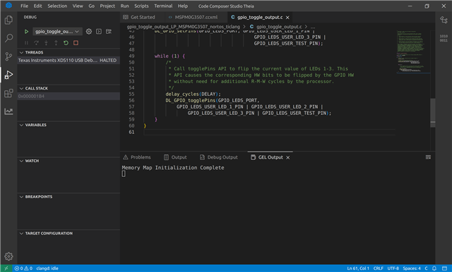

Restarting CCS-Theia has no effect, and the issue repeats itself.
However, on CCS Cloud, I can successfully program and debug, although the process is slower.

    Where exactly did you click debug? There are several places to do it.
    In your screenshot, I see the call stack at 0x1B4. Then entry point of main should be 0xC0 and if the program loaded correctly and auto-ran to main, you should be at this location

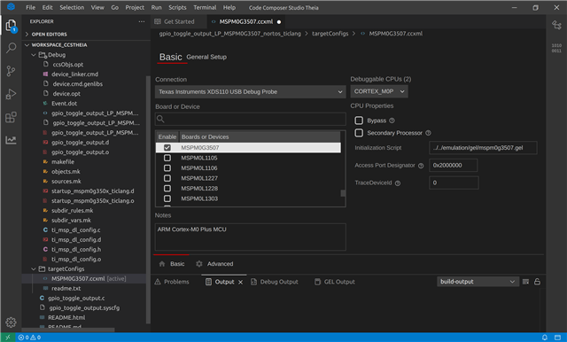

    Can you try to open the launch.json by clicking on the gear icon in the debug view toolbar and delete the launch configurations inside the JSON array?

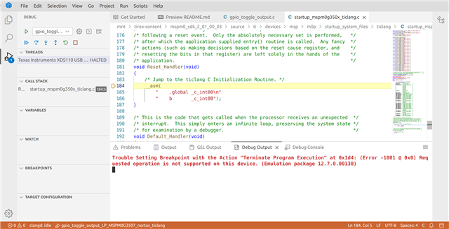

    can you explicitly go to "Run -> Load -> Load Program" and explicitly load your program?
    I tried,here is the screenshot:
    I chose a file with the .out suffix (not sure if this is the correct way to load it).
    And I don't know why the call stack changed to 0x1BA

    This is the content of launch.json. I tried to delete the launch configurations and regenerate, but the problem still exists.
    Thank you for your help!
