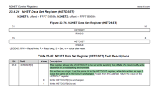

    So, in these kinds of situations you should not use DOUT register, instead of it would be better to use the HETDSET (to set a pin) and HETDCLR (to clear a pin) registers.
    So, example if you see HETDSET register:
    The bits you write 1 in this will only get set and remaining bits state will be unchanged.
    Similarly, for HETCLR register the bits you write 1 will get clear and all the remaining bits will be unchanged.

    I mean for example assume HET20 is at logic-0 before we read, and after we read assume, the value changed to logic-1(due to period or duty cycle time out). But we still have logic-0 and we write the same into the HET-20-bit value, but HET-20 should be logic-1 according to PWM but we are making it logic-0.
    This kind of race around conditions will occur if the two processors working independently. So, it would be better use HETDSET and HETCLR registers, these registers won't do read modify write they will only write to the corresponding bits which are 1.
