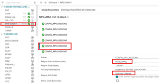

    3 My outbound setting are like the following picture, I don't know whether it could be seen by you. It's the original setting from //pcie_buf_transfer_rc
       4 After setting statusCmd and type0Bar32bitIdx, I try to write Bar1 of the EP, by the following code, but it seems it didn't work.

    in your previous post you're showing that the lower base address is 0x68000000 + 0x01000000, i.e. 0x69000000. If pcieBase is just 0x68000000 then I wouldn't expect that to work.
    How do you determine "didn't work"? The examples, e.g. pcie_msi_irq_rc use similar code, and they work (although the CacheP_wbInv shouldn't be necessary, because the 0x68... range is mapped as strongly ordered memory, and therefore doesn't cache).
    -> What exactly "didn't work"? Does it crash like the second post with pcieBase? Or something else?
    -> What kind of functionality did you implement in your FPGA behind Bar1?

    1 My setting of OB is: base address = 0x68000000 + 0x01000000, while I got the pcieBase from pcie_fpga_get_memSpace() is 0x68000000. Is it wrong?
    I'm not sure about the PCIe driver APIs for RC, e.g. which function should be used for what purpose... I'd use the CONFIG_PCIE0_OB_REGION<n>_LOWER generated for the outbound mappings from SysConfig.
    2 What is the proper way to access data Mem Bar1 of EP? memecpy() or  *((volatile uint32_t *)pcieBase) = 0xFFFFFFFF?
    Both should work. With memcpy() the compiler might make optimizations that are only valid for "normal memory" (i.e. cacheable, no strong ordering). Whether that is possible depends on how you configure the 0x68000000 region in the MPU, and it depends on the memcpy() implementation. For "registers" behind those BARs I'd make sure the MPU maps the memory as strongly ordered (maybe device, if you know what you're doing) and use *(volatile uint32_t*).
    3 Why my debug crashed when use *((volatile uint32_t *)pcieBase) = 0xFFFFFFFF way to write 0x68000000 or 0x68000000 + 1 or 0x68000000 + 0x01000000?
    Is it crashing for EACH of those addresses?
    I can understand why it crashes for an address range that is not mapped via an outbound memory region, but CONFIG_PCIE0_OB_REGION1_LOWER should work.
    Just to be sure:
    CONFIG_PCIE0_OB_REGION1_LOWER is 0x69000000, and it doesn't crash with memcpy, but it crashes with volatile uint32_t*?

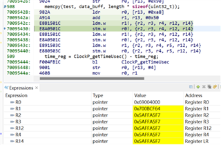

    But the following code cannot work.
    uint32_t * test = (uint32_t *)(0x69000000U + 0X00004000);
    uint32_t data_buff[64];
    uint32_t data_buff2[64];
    for(i = 0; i < 64; i++)
    data_buff[i] = i;
    memcpy(test, data_buff, 64 * sizeof(uint32_t));  // write EP
    memcpy(data_buff2, test, 64 * sizeof(uint32_t)); // read back, there all "0"!

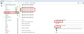

    I insert CacheP_wbInv(test, sizeof(uint32_t) * 64, CacheP_TYPE_ALL)  between this two memcpy(), and I also and some print() for delay purpose.
    But the read back data_buff2 always all "0".
    My questions is how can I use memcpy() to write EP' memory properly?
    Or should I just use "*test++ = i" way to write?
    Chunyang
  • Hello Chunyang,
    glad you got read/write basically working.
    Are you running a debug build or a release build? With release you could be running into problems with the compiler optimizing your code. I don't think that's currently your problem, but I wanted to make sure you're aware of that possibility. In your test code the optimizer could just optimize away any accesses to the FPGA.
    It seems that reading back from your FPGA with memcpy works just fine, just writing to the FPGA appears to be a problem. It would be good if you could verify that by using the same code, and just replacing the memcpy() that writes to the FPGA with a for(...)*ptr = *dst loop, and leave everything else the same.
    If it is really the memcpy then maybe the FPGA is having a problem with the PCIe transactions triggered by the memcpy vs. the 32-bit pointer access. The memcpy could be triggering larger bursts, and maybe that's something your FPGA can't handle?
    To verify that, you could try using a uint64_t pointer to write to the FPGA. memcpy could of course be using even longer bursts, but that's more difficult to reliably trigger. If writing using a uint64_t doesn't work either you'd have to look at your FPGA implementation.
    Regarding the use of CacheP: You need to check how you're configuring the MPU. Normally I'd expect the 0x68000000 range to be configured as strongly-ordered. In that case you don't need CacheP_wbInv.

      Would you please tell me why you said here, 0x68... range is Strongly ordered?
      I check the syscfg, in Ti SDK's example, CONFIG_MPU_REGION4(from 0x60... 256MB, is Cached)
       Should I change my syscfg, to modify this REGION4 to strongly ordered?
       Strongly ordered and Cached which one is more suitable for several 32bit data PCIe accessing?
    Chunyang
  • Hi Chunyang,
    I think Dominic is referring REGION6 as per "pcie_msi_irq_rc " example:
    While you are referring REGION4
    Ashwani

    It would also be interesting if you could assembly-step through the memcpy code to the point where the processor actually stores bytes to the 0x69000000 address.
    The following is the disassembly windows contents for memcpy()
    508 memcpy(test, data_buff, length * sizeof(uint32_t));
    70094898: 982A ldr r0, [r13, #0xa8]
    7009489a: A914 add r1, r13, #0x50
    7009489c: E8B1501C ldm.w r1!, {r2, r3, r4, r12, r14}
    700948a0: E8A0501C stm.w r0!, {r2, r3, r4, r12, r14}
    700948a4: E8B1501C ldm.w r1!, {r2, r3, r4, r12, r14}
    700948a8: E8A0501C stm.w r0!, {r2, r3, r4, r12, r14}
    700948ac: E891503C ldm.w r1, {r2, r3, r4, r5, r12, r14}
    700948b0: E880503C stm.w r0, {r2, r3, r4, r5, r12, r14}

          Following your guidance, I try to understand the difference between 16*32bit and 17*32bit writing.
          I noticed that if write 16*32bit, the assembly code use R2, R3... to move "0x5affa5f7", as the 1st following picture shows. While write 17*32bit, the assembly code will call _aeabi_memcpy which move "0x5affa5f7" split by byte, as the 2nd and 3rd pictures show.
          What is these meaning? I only should ues memcpy() to write less than 16*32bit?
