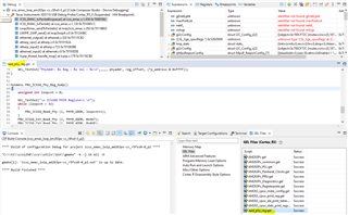

Troubleshooting Steps:
 I put breakpoints in icss_emac.c at, ICSS_EMAC_txPacketEnqueue(). This revealed that icss_emac transmit is executing.
 I put a breakpoint in lwip2icss_emac.c at  Lwip2Emac_sendTxPackets(). This breakpoint is not hit.

 I only notice the above error on the console when I halt the processor at a breakpoint. It Is possible that this causes a race condition.
Here are some expressions I captured when halted at ICSS_EMAC_txPacketEnqueue():

    1.
    Regarding:
    "Can you first check if the Link ISR is being triggered? Put a breakpoint in the ISR ICSS_EMAC_linkISR and disconnect or connect the cable on the port. The breakpoint should get hit."
    I tested the link ISR. If I start the application with the Ethernet cable disconnected, the Link ISR does not occur. Upon connecting it a breakpoint in the ISR is hit.
    This is a screen capture inside the ISR. I stepped through it to the end.

    I captured the ARP Announcement (transmission) from the Control Card in ICSS_EMAC_txPacketEnqueue().
    Note I am still seeing what appear to be packet allocation errors, although I cannot definitively conclude that these errors are the root cause to the dropped ARP transmissions.

    This is a view of CCS at the time.
    These are the variable at that time:

  • Hi Archit ,
    I wasn't able to run the gel script you provided; I've never done this before. I tried loading it in CCS, and executing functions in the script through the console, but that doesn't seem to be the correct procedure to run the script.
    Please provide a procedure to do this.
    Tollman
  • Hi ,
    In order to load the GEL file and read the PHY Registers, the following steps are followed usually:
    1. Add GEL file using Tools > GEL Files > Right click in the table under the "GEL Files" tab > Click on "Load GEL..." option.
    2. After initializing PHYs and ICSS MDIO, run the script from Scripts >ICSS_Configuration >PRU_ICSSG_PHY_Reg_Dump.
