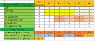

I made AM2634 test board and put the "WARMRSTn" pin floating.
When I powered my AM2634 test board, I watched only low signal on "WARMRSTn" pin.
When I added 10k-Ohm pull-up resistor, I found high signal with 3 ms delay after PORz signal.
1. In AM2634 datasheet, the pin type of "WARMRSTn" is "IO".
Is the method using pull-up resistor right?
2. It seems that I can set internal pull-up resistor for "WARMRSTn" via "MSS_IOMUX_WARMRSTN_CFG_REG".
But I can not find APIs dealing the registers.
I found "soc_rcm.h" and "soc_rcm.c" but they does not control "MSS_IOMUX_WARMRSTN_CFG_REG".

  • Hi, TI expert.
    I could change IOMUX settings of WARMRSTN pin using "pinmux.c"
    But, without external pull-up resistor on "WARMRSTn" pin, its output is always zeros.
    With external pull-up resistor on "WARMRSTn" pin, its output is high after PORz with a delay.
    This table is my result.
    I changed the values of IOMUX_WARMSTN_CFG_REG at CCS.
    The output pin of WARMRSTn is connected to TPS22918 load switch input.
    From my result, I concluded ...
    1. WARMRSTn is open drain output.
    2. Internal pull-up resistor for WARMRSTn does not operate.
    3. Internal pull-down resistor for WARMRSTn is 20 kΩ and can be used.
    4. Output override "0" for WARMRSTn can be used.
    Apologies, I missed that WARMRSTn is Open Drain pin. You're right, we would need an external Pull-up of 10kohm as present in the EVM schematics.
