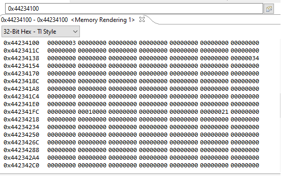

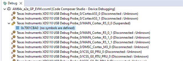

  • Can you once read the register 0x44234100 to determine the device type?
    In any case, may I know the reason for using this much old SDK version? Even if this issue gets resolved, we may not be able to spend time on the issues, if any, in the future with this SDK version.
  • I read the register 0x44234100, and the value returned is 0x00000003.
    The reason we are using this older SDK version (mcu_plus_sdk_am243x_08_03_00_18) is that our development is already completed with it. The only remaining task is to successfully flash the code to the flash memory.
    Thanks for the clarification!
    So, the device is definitely GP, you are flashing the right image types, & the flashing procedure looks good. I think it's time to confirm the actual content of the flash at offset 0x0.

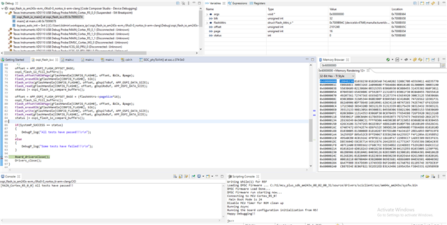

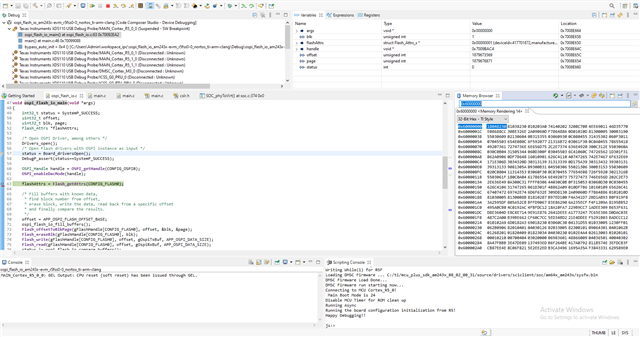

    Can you load any OSPI example preferably OSPI_FLASH_IO & stop the execution just after the Board_driversOpen call?
    Assuming the flash will be in DAC at this point, please check the memory at 0x60000000 using Memory Browser view. Do you see the bytes matching with the hex dump of the flashed SBL image?
    Prashant
  • Hello Prashant,
    I followed your suggestion and loaded the OSPI_FLASH_IO example, stopping the execution right after the Board_driversOpen call. However, when I checked the memory at 0x60000000 using the Memory Browser, I didn’t see any content. The memory seems empty, and no bytes are matching the hex dump of the flashed SBL image.
    Please let me know your thoughts on this or if there’s anything else I should try.
    Divyesh Patel
  • The memory seems empty,
    It looks like the DAC is not enabled. Can you check after the first R/W test? The "Flash_read" should leave the flash in DAC state. You may let the R/W happen since it does not conflict with the address 0x0.
    If you still do not see any content, you may enable DAC manually with the following patch
    diff --git a/examples/drivers/ospi/ospi_flash_io/ospi_flash_io.c b/examples/drivers/ospi/ospi_flash_io/ospi_flash_io.c
    index 4a5fe56cebd..3eda4f4f58d 100644
    --- a/examples/drivers/ospi/ospi_flash_io/ospi_flash_io.c
    +++ b/examples/drivers/ospi/ospi_flash_io/ospi_flash_io.c
    @@ -57,6 +57,9 @@ void ospi_flash_io_main(void *args)
         status = Board_driversOpen();
         DebugP_assert(status==SystemP_SUCCESS);
    +    OSPI_Handle handle = OSPI_getHandle(CONFIG_OSPI0);
    +    OSPI_enableDacMode(handle);
         flashAttrs = Flash_getAttrs(CONFIG_FLASH0);
         /* Fill buffers with known data,
    I ran the R/W test as suggested, and the memory at 0x60000000 is now showing hex values.
    I also tried manually enabling DAC, and it displayed the same hex values as after the R/W test.
    Please let me know if this confirms that DAC mode is functioning properly or if there are any further steps to take.
    Divyesh Patel
    Yes the flash is in DAC mode. The SBL image seems to be flashed. Can you compare few initial bytes with the hex dump of your actual SBL image just to be sure the image is flashed correctly.
    If you think the image is flashed correctly, can you checkout the Section 1 of this FAQ & see if anything stands out that may explain the issue?
    https://e2e.ti.com/support/processors-group/processors/f/processors-forum/1358039/faq-board-bring-up-tips-for-sitara-devices-am64x-am243x-am62x-am62ax-am62px

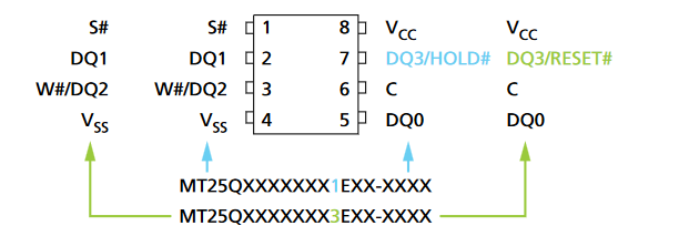

    Since we are booting from SPI, the OSPI0_CLK toggles at 6MHz, and when the clock is present, the OSPI0_CSN0 pin goes low.
    It looks like the ROM is trying to talk to the flash. Do you see any activity on the data lines?
    Apart from this, does your board schematic adheres to the following requirement mentioned in the TRM chapter 4.4.1 OSPI, xSPI, QSPI, SPI Boot
    Prashant
  • hello,
    Yes, I do see activity on the DQ0 pin.
    In our board, the flash reset pin is connected to the DQ3 pin. From the hardware side, it's not possible to directly reset the flash.
    Could you suggest how we can perform a flash reset in this scenario? Any software-based workaround would be helpful.
    Divyesh Patel
  • Hi, please checkout the following snippet
    /* File: source/drivers/ospi/v0/ospi_nor_flash.c */
    int32_t OSPI_norFlashInit1s1s1s(OSPI_Handle handle)
        /* Reset the Flash */
        cmd = OSPI_NOR_CMD_RSTEN;
        OSPI_norFlashCmdWrite(handle, cmd, 0xFFFFFFFF, NULL, 0);
        cmd = OSPI_NOR_CMD_RST;
    I am not a hardware expert but there should be a provision of completely shutting down the flash with Cold POR via PMIC. Isn't it the case with your board?
    We do have a button for completely shutting down the flash via Cold POR using the PMIC, but unfortunately, it still doesn't resolve the issue.
    Divyesh Patel
  • Divyesh, how did you confirm your code flashes the LED?  Did you load it by some other means and test it on the board?
    Earlier in the thread you mentioned the code never gets out of 0x41xxxxxx area of memory.  Is this still the case?  Does it ever execute in the area of 0x700xxxxx?  Can you confirm if the full SBL image gets downloaded to internal memory?
    James
  • Hi James,
    I confirmed my code flashes the LED by running the SoC initialization script and loading it onto the EVM board, where it works as expected. However, using the same procedure on my custom board, it doesn't work.
    In SPI boot mode on my custom board, the code remains in the 0x41xxxxxx memory area and never executes in the 0x700xxxxx region where the application should run. I verified this by checking address 0x6080000 and using the OSPI_jtag_uniflash example to confirm the image is correctly programmed into flash memory.
    If there is any other method to verify this, please let me know.
    Divyesh

  • Hello James,
    Apologies for the miscommunication. In Dev Boot mode, after running the SoC initialization script on my custom board, the LED blink code works perfectly.
    However, after using the "sbl_jtag_uniflash_am243x-evm_r5fss0-0_nortos_ti-arm-clang" example to upload the code onto my custom board, the upload is successful. But once I change the boot mode to SPI boot, the code does not boot.
    Divyesh
    Yes, the code now executes in the 0x700xxxxx memory area, but the LED blink code still doesn't work.
    For debugging the SBL boot, I followed the steps outlined in this thread: https://e2e.ti.com/support/processors-group/processors/f/processors-forum/1294675/faq-am62x-am64x-faq-debugging-sbl-boot-in-rtos-sdk , it confirmed that the image is downloaded to internal memory by checking the 0x6080000 and 0x6000000 memory addresses.
    For booting, I'm using B0-B7: 11001110, B8-B15: 00000000 in XSPI bootmode.
    Divyesh
