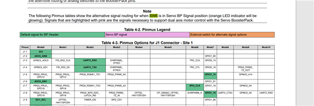

    Are you setting the switch sw6 of the AM243X board for booster pack pin routing? To route channel 2 pin for booster pack you have to set SW6 in booster pack mode as mentioned in the Am243x LP user guide. AM243x LaunchPad Development Kit User's Guide (Rev. F) (ti.com)

    • SW6 of am243x board should be in servo BP single position mode
    • encoder2 should get 5V power

    can you check which version of am243x board you are using? Not all am243x boards have 2 channel support, The board which has switch SW6 & written PROC109A on it, supports both channels.

    your advice with the switch was correct - thank you. I didn't know about the SW6. It would be very helpfull, if all instructions regarding the dual motor example would be in one file.
    Now both encoders are initialized. So my first two questions are answered.
