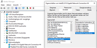

  • Sure, I have connected the LP-AM243 directly to a windows computer. On this computer I have a little DHCP Tool handling the DHCP requests.
    As I run the DHCP server on the computer I am able to change the Link-Speed settings in device manager:
    - "Automatische Aushandlung" will select 1 Gbps connection, board also prints "1-Gbps Full-Duplex"
    - e.g. 100-Mbps Half-Duplex, will select 100 Mbps connection, I will be able to see requests and get IP address

    I am not sure what you mean with "D-LINK Desktop Switch". I had a unmanaged Gigabit Switch (Netgear GS308). If I connect LP-AM243 and desktop PC running DHCP server to this switch the behavior is the same. I do not get any IP address and do not see any requests.
    Actually it's even worse, as forcing 100 Mbps on the network card of desktop PC won't get board to work, as board exchanges speed info with switch and stays at 1 Gbps.
