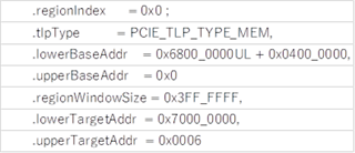

To be specific, PCIe driver uses the structure “Pcie_ObAtuCfg” to set it up.
As only BAR0 is used in the case of accessing PCIe 32-bit address space,
if set like below,
Destination PCIe address = 0x7000_0000
reginWindowSize = 0x3FF_FFFF
and then,
The structure “Pcie_ObAtuCfg” would have only one array member like below.
On the other hand, they think that two of BAR0 and BAR1 must be used in the case of accessing PCIe 64-bit address space.
Destination PCIe address = 0x0006_7000_0000
ReginWindowSize = 0x3FF_FFFF
And then
Should they set two array members of the structure “Pcie_ObAtuCfg” ?
For example, like below
Alternatively, is BAR1 automatically set and used when BAR0 is set ?
However, it seemed to be 32bit PCIe address when they tried to set only BAR0.
