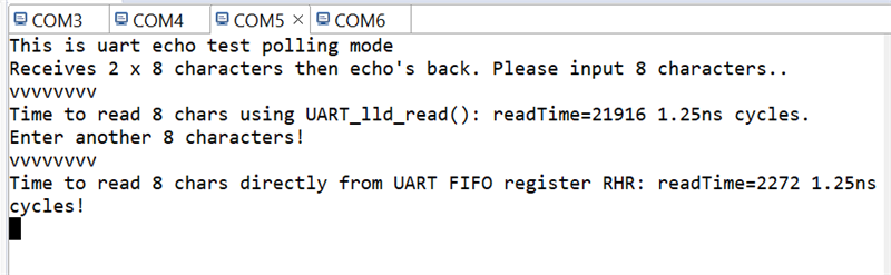

  • Example_demonstrating_long_UART_register_access_times.zip
    I have modified the uart_echo_polling_lld_am243x-evm_r5fss0-0_nortos_ti-arm-clang example from mcu-plus-sdk to demonstrate the problem.
    It essentially does the following:
    1. Wait for the user to enter 8 characters (it waits until they have arrived in UART RX FIFO).
    2. Read the data using the API function UART_lld_read() and measure the time it takes.
    3. Ask the user to enter 8 more characters and wait until they have arrived in UART RX FIFO.
    4. Read the data directly from UART FIFO register RHR and measure the time it takes.
    This is the output I get:
    This is uart echo test polling mode
    Receives 2 x 8 characters then echo's back. Please input 8 characters..
    12345678
    Time to read 8 chars using UART_lld_read(): readTime=17221 1.25ns cycles.
    Enter another 8 characters!
    12345678
    Time to read 8 chars directly from UART FIFO register RHR: readTime=2152 1.25ns cycles!
    The 17221 cycles the API function takes to read 8 chars is insanely long!
    But also reading the 8 bytes directly from FIFO register takes 2152 cycles (2.69 µs). This is much longer than we had expected!
    Please tell us how to get the data quicker. We seriously hope it is only because of a misconfiguration on our side.
    Best regards
    Johannes

  • Hello Anil,
    I reproduced the result with Johannes' project. The time measurements were:
    Debug:
    Time to read 8 chars using UART_lld_read(): readTime=21942 1.25ns cycles.<\r><\n>
    Time to read 8 chars directly from UART FIFO register RHR: readTime=2221 1.25ns cycles!<\r><\n>
    Release:
    Time to read 8 chars using UART_lld_read(): readTime=17215 1.25ns cycles.<\r><\n>
    Time to read 8 chars directly from UART FIFO register RHR: readTime=2139 1.25ns cycles!<\r><\n>
    Which measurements do you get?
    From my point of view, the compiler settings have only very little influence here. Especially when we access the UART_RHR bare-metal.
    We need information on the internal access times of the AM243x SOC and how to modify them.
    BR
    Alexander

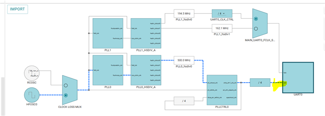

  • Hello Vaibhav,
    I don't think we can debug further this issue because the R5F core is taking almost ~21 usc to read 8 bytes from the FIFO in release mode with the TI API.
    The UARt ICLK runs at 125MHz and can't increase the UART I CLK more than 125MHz.
    We need to check with the internal team to discuss further the test results.
    Anil.

  • Hello Alexander/Future readers ,
    The above results with FIFO mode reading data 8 times to the RHR register and SOC took almost 2.6usec to complete its operation.
    This is acceptable and, beyond this, time can't decrease further.
    The SOC can take almost 200nsec - 400nsec to read one 32bit of data.
    Here, in the above example, the user is reading data to 8 bytes of data, and it will take almost 8 * 0.2usec or 8 * 0.4usec = 1.6usec or 3.2usec.
    If a user wants to speed up the UART processing, then the user should go with DMA and when the user goes with DMA, then if the UART data size is fewer bytes, like 8 or 12 bytes, then there is no benefit to going with DMA as well, because to start the DMA, SOC need to control the DMA start register and which is 64bit and to complete this operation SOC may take almost 0.4usec time to 0.8usec time and along with this user should have penalty for the cache operations for write and read cycles. So, the DMA is not much improved when going with lower bytes.
