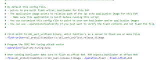

  • The latest version of SDK used OSPI tuning data:
    In the file: C:\ti\mcu_plus_sdk_am263px_10_01_00_27\tools\boot\sbl_prebuilt\am263px-cc\default_sbl_ospi.cfg
    You can see the we send the OSPI tuning vectore:

  • How does this Python tool know that the correct address for this data is 0x80000 when, in the same tool, this address is the default for the app image? (I'm not analyzing this tool.)
  • The python tool takes the address based on the cfg file that is present in sdk:
    this was updated in latest version of sdk.
