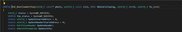

They recently meet a strange problem when Ethercat upgrade in flash.
If the UART DMA is enabled (non-cacheable) when Ethercat upgrade, write value 1 to the flash address 0x7e000, the read out value at the same flash address is 0 not expected 1. The same situations happens for writing many other address in the flash also.
If the UART DMA is disabled when Ethercat upgrade, write value 1 to the flash address 0x7f000, the read out value at the same flash address is 1 as expected. And it is working in all other address writing.
This really confuse customer how the UART DMA could somehow affect the ethercat flashing values.

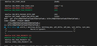

    Can the customer share the interrupt and task priorities? We suspect if the higher priority task/interrupt is preempting the Flash read task.
    Aaron
  • Hi Aaron,
    The tasks running apart from Ethercat flashing are IPC communication & UART DMA. We are not quite sure how to look at the priorities, but customer provided the syscfg files below, so maybe you could more conveniently look at it.

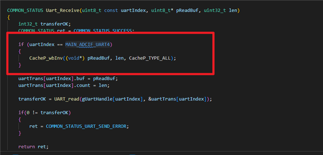

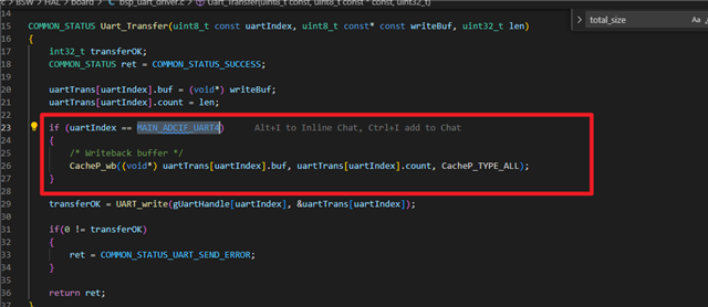

    What is the meaning of UART DMA being non-cacheble , which means the buffer that is used for UART communication is kept then as non-cacheble?
    If UART buffets are non-cacheble, then why user use Cache_wb and Cache_Inv API's in the above attached images ?

    If UART buffets are non-cacheable, then why user use Cache_wb and Cache_Inv API's in the above attached images ?
    Customer feedback: We just directly use the default SDK configurations according to the uart dma demo,  we did not intentionally configure them. If you think the default Cache_wb and Cache_Inv API will make UART buffer become cacheable, then we could do an experiment to remove them.

    What are the priorities for all the tasks ?
    Customer feedback
    Uart
    IPC
    Ethercat

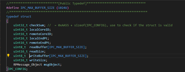

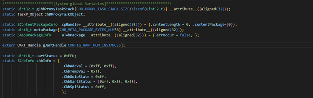

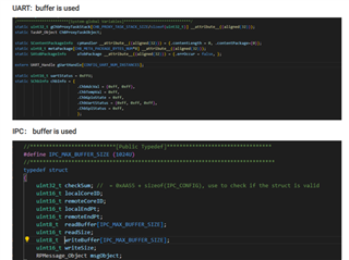

    Can you also please confirm whether the source buffer and destination buffers belong to flash memory or which memory is used?
    Customer Feedback:
    UART:  buffer is used
    IPC: buffer is used
    Ethercat read/write flash: buffer is used

    static EChBProxyState nackSendAct(void)
        int32_t ret = SystemP_SUCCESS;
        // When there is an error, transfer the nack package to B side.
        ret = Uart_Transfer(CHB_PROXY_TASK_UART_TRANS_INDEX, aTobPackage.nackPackage, ACK_PACKAGE_NUM);
        // Waiting for transfer done.
        SemaphoreP_pend(&gWriteDoneSem, SystemP_WAIT_FOREVER);

    static EChBProxyState contentRevStartAckSendAct(void)
        int32_t ret;
        // Start content package receive(Prepare for content package DMA)
        Uart_Receive(CHB_PROXY_TASK_UART_TRANS_INDEX, cpHandler.contentPackage, cpHandler.contentLength);

    For the last year project, customer only used R5F0_0, and there is no problem. This year new project introduced the R5F1_0, and the overall system will occur this problem.
    Customer has mentioned that they have tried to avoid the on-chip ram overlap for different tasks by setting different buffer shown below (you could refer to the previous reply which has this information).
    Kevin
  • Hello Kevin,
    Please try the following test cases:
    Test Case 1: Swap Task Priorities
    In the customer application, the following task priorities are currently configured:
    • UART Task Priority: 4
    • EtherCAT (OSPI Write) Task Priority: 2
    Modify the configuration as below:
    • Set UART Task Priority to 2
    • Set EtherCAT Task Priority to 4

  • Hi Anil,
    Please see the result of the above 3 test cases, thanks.
    Modification
    Result
    This UART operates as a slave, connected to an external UART master device. The master device continuously sends data every 10ms. However, the priority level of the UART task is set too low, causing the receive buffer to overflow. This results in error reports and triggers a watchdog timeout reset due to unprocessed data.

  • Test Case 2: Buffer Memory Placement
    Modification
    Hello Kevin,
    I believe that based on the above test results, modifying the priorities of the UART Task and EtherCAT Task may be causing task starvation for the UART Task.
    This implies that higher priority tasks are preventing the UART Task from executing, resulting in the UART Task not being able to process incoming data in time.
