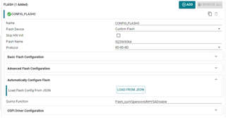

If I don't check the box [Disable Auth For Application Image], there is a status = SystemP_FAILURE from Bootloader_parseMultiCoreAppImage(bootHandle, &bootImageInfo);
but, if I check the box [Disable Auth For Application Image], there is also a status that the app cann't run:
so, where is the msitake i had? how can i do to run the app form sbl_ospi ?

  • sdk:     ind_comms_sdk_am243x_09_02_00_15
    flash:   IS25WX064
    chip:    AM2432
    i have test teh examples of ospi_flash_diag/dma/io, and all of these can be run correctly.

  • Hi Meet,
    first, the examples of ospi_flash_diag/dma/io can be run correctly with the sdk_mcu in ind_comms_sdk_am243x_09_02_00_15 using the flash chip of IS25WX064.
    then, when using the sbl_ospi th boot app, the app can not run, the uart debug information are:
    but, when i change the flash chip to S28HS512T(both change in syscfg and board),the sbl_ospi can run the app correctly.
    so ,the problem is also why i cann't using the is25wx064 in sbl_ospi to runing the app? where are the problems?
    Joe.
  • when i change the Input Clock Frequency to 200MHz, the problem was solved.
