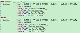

  • I noticed that in the linker cmd file of example project "memcfg_ex1_ram_management_cpu1":
    the code was loaded is LSxRAM and RUN in GSxRAM,
    but I want to load and run in the GSXRAM, cause the cpu2 can write to GSxRAM until the permission from CPU1, then can the code be loaded to the GSxRAM before that?
    just like the below:
    thank you!
    Debugger (JTAG) access is allowed from both the CPU irrespective of the permission so you should be able to load the code from CCS.
