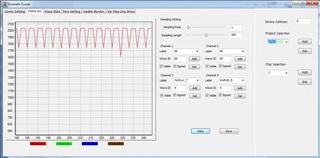

I have a customer meet CLA reading ADC result error.
They found this by ADC reading result abnormally, in detail, it is much higher than the sampling value. It happened at specific condition: the inverter is connected to the grid normally, and then the PV source voltage is pulled down and disconnected from the grid, it may trigger an error 427 (abnormal sampling of both AC current and voltage). The duration varies from 0.5 to 2 minutes, and then it can return to normal.
Then they draw the ADC result and CLA reading ADC result using their own GUI.
Green line is ADC result.
Red line is CLA reading result, and sometimes it is too high sometimes it is too low.
Next they check the ADC result in CLA directly and it is not right, either.
They did not give the register to a variable but just read the value and judge. The value should NOT below 800 as showed in the graph.

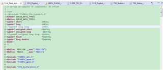

  1. Confirm CLA typedef information. As showed in this thread, just check whether this error. e2e.ti.com/.../c2000-cla---accessing-adc-results-register-from-within-cla-task
I just found they just put the useful CLA type define in their source file and before including other header file.
2.I have also checked the CLA configuration and CLA CMD. I did not found error.

  • Hi Emma,
    Thanks for the additional information. I am still not clear a 100% on what the customer expects to see and what the customer is getting.
    Is the green line showing ADC result 3 being read from C28 CPU and is the red line ADC result 3 being read by CLA at around the same instance - I assume ADC is set to interrupt C28 and CLA to be able to capture these results.
    It looks like red line is showing 1/2 the value shown in green line. Am I reading this correct?
    I read throug all the CLA ADC issue thread, just found it is the main root cause
    1.so I just want to check, if they put the type define in source code, it is same as including “F2837xD_Cla_typedefs.h” ?
    2.for the code they just read the ADC value and judge in CLA task.(the fifth code in this screen shot)
    what the data type will be?

    1. It looks like the correct data type is being used - if header file is removed and types are specified in the source code then the types defined in source code will be picked up. From the assembly we can see that the ADCRESULT3 has been converted to 0xB03 address in the assembly code which is the correct address. If the type was incorrect, the address would have been incorrect.
    2. Given that the type is an unsigned type, the Left and Right shift operations do seem unnecessary - the operations are needed for signed types however so that the 16-bit value gets correctly sign extended as a 32-bit value. Given the ADCRESULT is an unsigned short type and 12-bit value, the most significant bit will always be 0. The shift operations should not result in a negative number.

    Acturally, the same code and same board failed at a certain times.
    And more weird thing is, during the failing time. the CLA reading result is not all wrong. it may be 1 wrong value followed a right value.
    and it may happen that the voltage is correct and the current is wrong or vice verse.

    In the image where you have green and red waveforms, are you sure that you get 1 CLA ADC reading for every 1 C28x CPU ADC reading?
