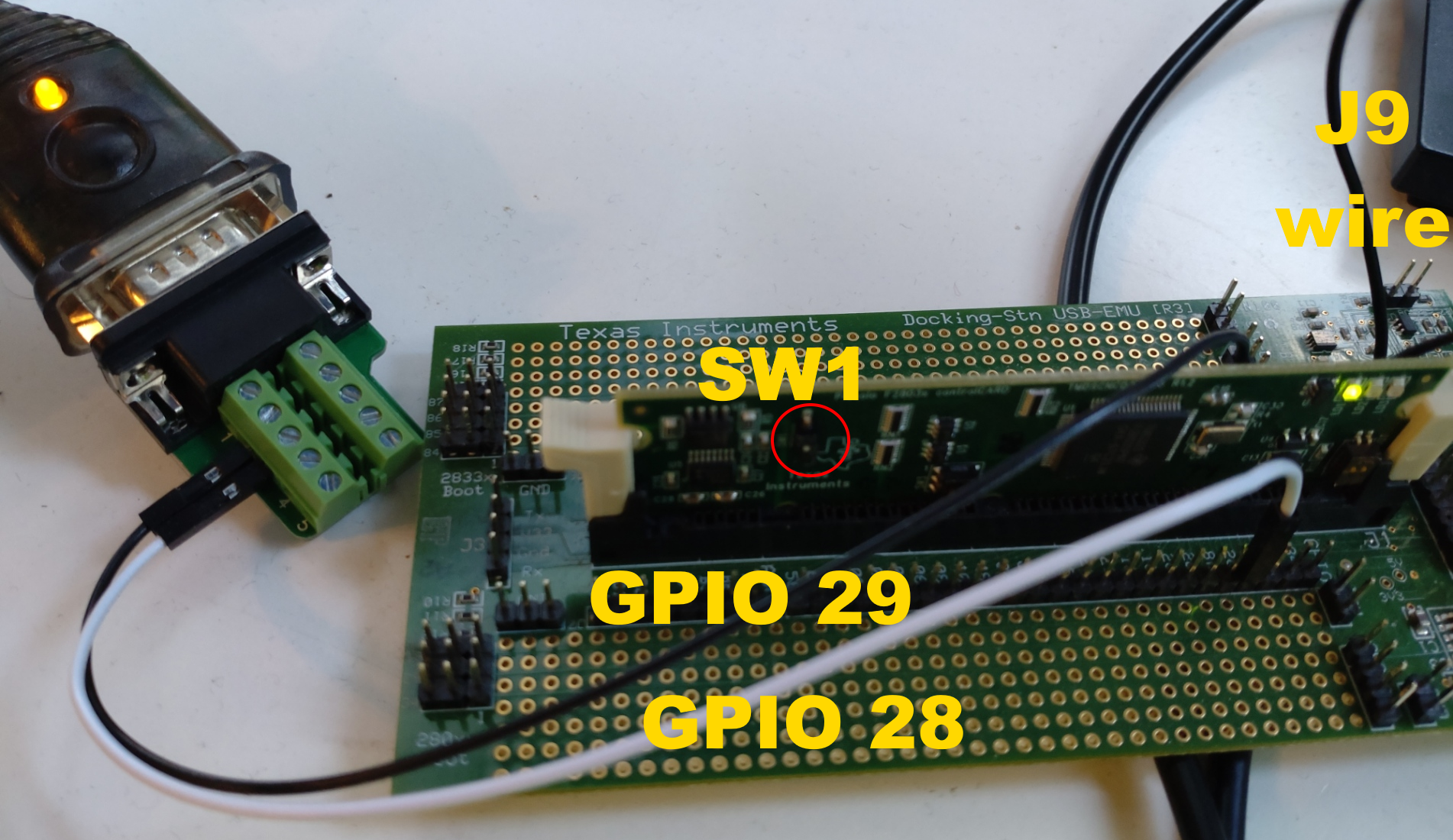

I am trying to get the example SCI_Echoback to work, but I cannot, and I don't understand what I am missing.
  1. On the MCU card, I have tried with both, SW1 in the ON and OFF positions.
  2. On the docking station of the Experimenter's Kit, I have shorted JP9 (it was open, now it's closed).
  3. I have connected GPIO 28 to RS-232 PIN3 and GPIO 29 to RS-232 PIN 2.
Not only do I not get a response (Rx), I don't seem to get the transmission (Tx) either.
So, I need to ask:
  1. For SCI serial communication via RS-232, should other pins get connected as well? If yes, which?
  2. Should SW1 on the MCU board be set to ON or OFF?
  3. Have I forgotten something?

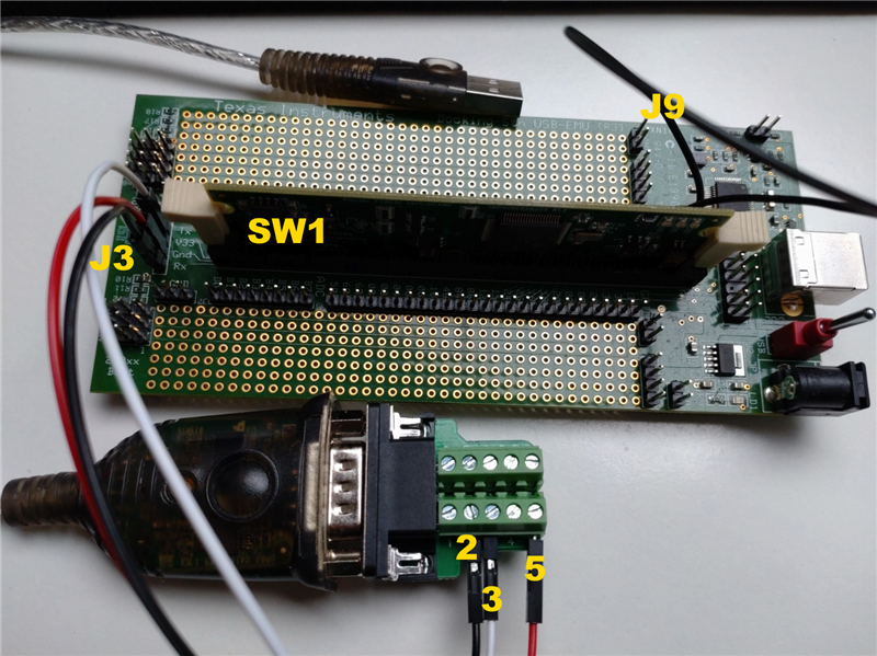

  • Thank you Marylin,
    I have tried as suggested:
    1. RS-232 PIN 2 connected to Rx.
    2. RS-232 PIN 3 connected to Tx
    3. RS-232 PIN 5 connected to GND
    4. SW1 is on ON - default was off (?) and switched position.
    5. J9 is still shorted, as seen below.
    But I still did not see anything on terminal using the correct port settings, not in a serial port monitor application.
    Robin

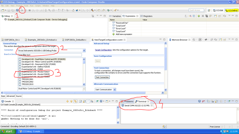

  • Hi Marylin,
    I've tried with the new configuration, to no avail.
    1. The program is running.
    2. The debug probe driver is installed, tests are successful.
    3. The correct device is selected as a target.
    4. No welcome message from the program, despite the fact that the serial terminal is connected to the correct device.
    Of course:
    * SW1 is in OFF.
    * JP9 is shorted.
    Robin

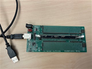

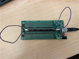

  • Hi Robin,
    On the COM port associated with the XDS100 probe, I managed to receive the text, but I was unable to send (or, the device was unable to receive), although J9 was shorted
    What position is SW1 in?
    Could you please try to run the sci_loopback example and verify that with SW1 in the ON position, J9 shorted, and then the RX ISO/TX ISO pins connected you are able to see communication? The only change needed in the example is disabling the internal loopback:
    	//SciaRegs.SCICCR.bit.LOOPBKENA =1;       // Enable loop back
        SciaRegs.SCICCR.bit.LOOPBKENA =0;
    Also, what is your connection like for the RS-232? In the attached pictures I can see the connection you have with the docking station but not to what that is being connected to.
    Marlyn

  • Hi Marylin,
    I have managed to get the RS-232 communication working.
    After confirming, using the loopback example above, that the HW is OK, and that the SW is OK (it does transmit), I've proceeded to test the RS-232 adapter and the wiring.
    The mistake that I did was:
    * I wired Rx pin on the docking station to the Rx pin of the DB9 connector (pin 2)
    * I wired Tx pin on the docking station to the Tx pin of the DB9 connector (pin 3).
    How I made it work:
    * I wired Rx pin on the docking station to the Tx pin of the DB9 connector (pin 3)
    * I wired Tx pin on the docking station to the Rx pin of the DB9 connector (pin 2)
    Of course:
    * SW 1 is ON (RS-232 is enabled)
    * JP9 is shorted.
    Thanks so much for helping me debug this, and resolving my communications problem.
    Robin
    P.S. The source code clearly states how to do the wiring, not sure how I've missed this. :(
