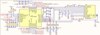

HI, expert:
Now I have completed the experiment of Ethercat function of F28388D ControlCard (its software location is: D:\ti\ C2000 \C2000Ware_MotorControl_SDK_3_01_00_00\solutions\ TMDXIDDK379D \ F2838x), I was able to scan the device successfully using Twincat software and communicate with CCS software. I then modified the code to be used on the control board of my own design (the chip is also F28388D),However, it is a pity that I could not successfully scan the device using Twincat software.I need your help to confirm the following problems:
1.Please help to confirm whether my EtherCAT circuit diagram design is correct as follows?
2.I saw the following configuration in the experimental software of Ethercat function of F28388D ControlCard. May I ask whether the control board designed by myself should also have this part of configuration? Is this part of the configuration necessary?After checking the circuit diagram of TI, I found that GPIO of these functions was not used, so my software deleted this part of the code on the basis of TI routines.

  • Hi Johnson,
    I will need some time to review and get back to you. How are you currently clocking the PHYs? Can you provide that part of the sch?
    It may be good for you to request the Ethernet PHY team review as well by posting on their forum.
    You're right that these signals aren't required.

  • Hi,Kevin:
    Thank you very much for your patient reply!
    1.
        In terms of circuit design, my clock here is from an external clock source.
    2.
     ok!Thank you for your confirmation.
    If there are no errors in the hardware design, I think I should look for errors in the software. Unfortunately, I searched for a long time and did not find any mistakes. Can you provide some ideas here about Twincat software not being able to scan the device?

  • Hi Johnson,
    I just realized the SW solution you are currently using. Please use the software examples available in the C2000WARE installation directory below. Also see the SW User's Guide available in the \doc folder of this directory, as it will guide you through using F2838x EtherCAT and software.
    C:\ti\c2000\C2000Ware_4_01_00_00\libraries\communications\Ethercat\f2838x
    If you made changes to the F2838x device pins used for EtherCAT (which I can't tell from the schematic images provided) you will need to make changes to the 'setupESCGPIOs()' function for the respective signals.
    Kevin
