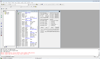

I have the same issue I have a board and have a TMX320LF2407A IC with a JTAG header. I have a XDS510LC
USB JTAG Emulator from spectrum digital. I have downloaded CCS3.3 and I can connect to the controller using JTAG. I can run and stop the processor thus my connection is ok. Since the TMS320LF2407A is not DSP read protected, I am able to save the contents of the TMS320LF2407A with the following steps.
File/Data/Save../Coff(*.out)
“Storing Memory into File”
“Address: 0x0000”
“Length: 0x8000”
“Page:  Program”
            “DATA”
            “ I/O”
1-Before saving, a small window titled "Storing Memory Into File" appears, as in the photo above, and there are three options for saving in this window, "Program-Data-I/O"
Which of these should I choose when saving? "Program" or "Data" or "I/O"
2- I have one working and one broken PCB's with this DSP on them. When I save the "Program" and "Data" in the DSP of the defective PCB separately and save the intact DSP in the same way, I saw that the "Data" codes of the non-working card were deleted, the "Program" codes are exactly the same when I compare them to the intact card. that is, only the "Data" part of the faulty card has been deleted.
3- How can I upload the "Program-Data-I/O" files in (Coff.out) format that I got from the TMS320LF2407A, which works without any problems, separately from the "On-Chip Flash Programmer" window?
For example, how can I load (program) only the "Data" file.
4- When flashing another Data file from the TMS320LF2407A (On-chip Flash programming) window to the old DSP, in the clear step, gives the error message; "Error: Read status value 0x0001 from symbol PRG_status
Flash algorithm failed during clear operation". How can I resolve this situation?

    First of all, thank you very much for your reply, there is data in the "Data" section. I saved this section and the data is visible in the hex editor. When I read the DSP of a circuit that works without problems and the DSP of another circuit that does not work, only the "DATA" part of the broken circuit seems to be deleted and there is no damage in the "Programs" sections.
    Please how can I program only the "Data" part via "On-Chip Flash  Programmer" or another tools?

    One more important question: Why doesn't this process take place when I select "Clear, Erase, Program" from the "On-chip Flash Programing" section? I can't perform Erase, Clear, Programming, it keeps giving the same errors:
    Error: Read status value 0x0002 from symbol PRG_status
    Flash algorithm failed during erase operation
    Make sure the file you are trying to reprogram has been downloaded from Flash. You are not trying this operation with data saved from RAM. Also make sure VCCP pin is connected to 5v.
  • Dear Hareesh
    Thank you very much for your valuable information. As you said, VPP was giving that error because it was not 5 volts, now I have VPP 5 volts, it erased the DSP, but it gives this error during the Flash programing  phase "Conversion aborted: This file is not linked"
