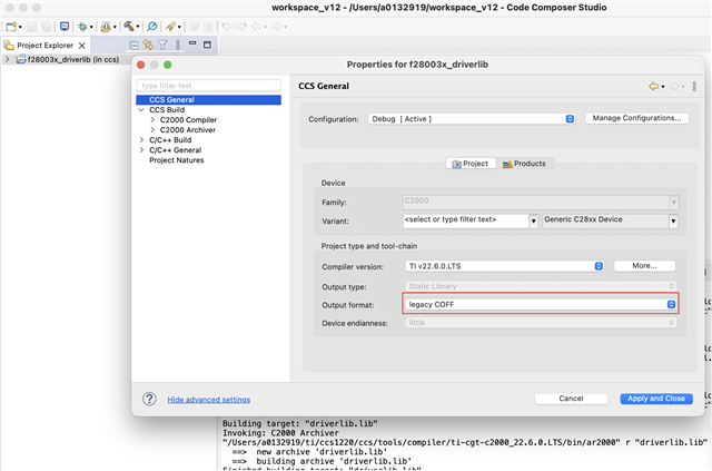

We want to use COFF format driverlib for our project but since there is no COFF format driverlib for 28003x and only have EABI format, we migrate it to COFF format refer to the link below:
software-dl.ti.com/.../C2000_c28x_migration_from_coff_to_eabi.html.
Now we found CLA cannot be compiled.
Then we found if we use sqrt() in CLA instead of __sqrt() it will be compiled well. Is there any difference between the two functions in COFF or EABI format?
