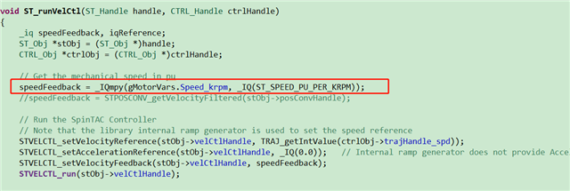

When the motor speed increase to 3700rpm, motor speed gMotorVars.Speed_krpm change from IQ(3.7) to IQ(-3.1). It cause the PID out of control;
In order to verify this issue is not cause by the encoder,   we change the encoder line from 1024 to 512, the issue still existed.
So customer confirm that this issue is cause by qep sample, so they change replace qep by observer which used to measure speed. So the software start to work well. Here is the code for the observer:
                // get the speed estimate
                gMotorVars.Speed_krpm = EST_getSpeed_krpm(obj->estHandle);
Customer also share the code of qep:
                 // get the speed from eQEP
                gMotorVars.Speed_krpm = _IQmpy(STPOSCONV_getVelocityFiltered(stObj->posConvHandle), _IQ(ST_SPEED_KRPM_PER_PU));
For qep rotation speed acquisition, customer call the function in the red box in the figure below:
Here is the original code:
6. Support need
Could you share the original code of the function that marked by red line? So customer can find the detail cause of this issue.

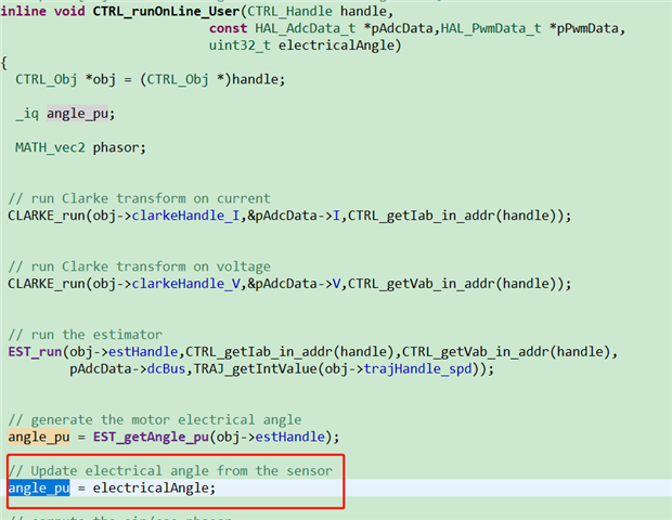

    According to the customer’s current feedback, the following results can confirm that the encoder is working normally, and the program itself has no problem, but the encoder’s speed calculation part is abnormal. Customer hope us can provide us with relevant codes for the encoder’s speed calculation, so as to analyze the cause of the failure.
    The current situation is that using the following configuration, the motor works normally, and the maximum speed can reach 5300rpm (the speed obtained by the estimator):
    1. The rotor angle adopts the value of the encoder, as shown in the figure below:
     2. The rotor speed adopts the value of the estimator;
    At present, there is still a small problem with the speed estimator, that is, the estimated speed at low speed is not stable, so our program sets the encoder speed when the estimated speed is lower than 1000rpm, so that the motor can barely work normally, as shown in the figure below Show.
