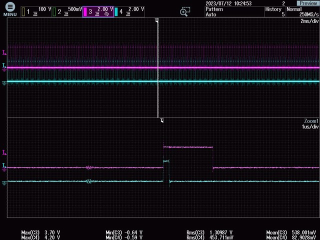

There are two EPWMs (EPWM3 & EPWM8) operating in 18kHz independently, and both are set in up-down count.
Both EPWM CMPA registers are configured as below which the CMPA values are given between 125 and 0 in a while loop.
while(1)
    if (a)
        EPwm3Regs.CMPA.half.CMPA = 0;
        EPwm8Regs.CMPA.half.CMPA = 125;
        a = 0;
    else
        EPwm3Regs.CMPA.half.CMPA = 125;
        EPwm8Regs.CMPA.half.CMPA = 0;
        a = 1;
The compare registers for both EPWM are in shadow mode, and load on when both CTR = PRD and CTR = Zero. Besides, the AQ is set High when CTR = Zero, and set low when CTR = CMPA for both EPWM3 and EPWM8.
(1). From above EPWM configuration, both EPWMs should take turn to have the EPWM signal (Figure1). However, somehow it is found out that either one would miss the output in a turn or have a short pulse which is supposed not to be there in random as below waveforms (Figure 2&3) .
(Figure1) Operating correctly. EPWM3 & EPWM8 take turn to have the EPWM signal in every period
CH3 : EPWM3 ; CH4 : EPWM8
(Figure2) Abnormal. EPWM8 has a abnormal short pulse ~200ns happening randomly
(Figure3) Abnormal. EPWM3 misses a output in a period, circled in red.

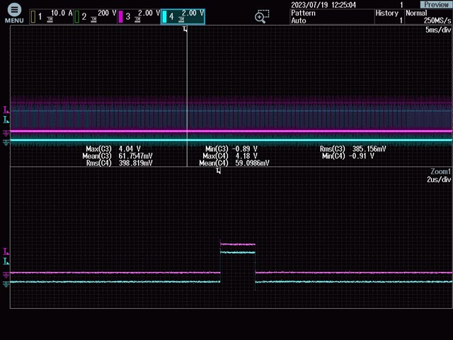

(2). With the same CMPA configured for both EPWM3 &  EPWM8, modify to load on CTR = PRD only. It is found out that either one EPWM would have the same consistent duty outputting at the same time or either one EPWM would miss the output in random.
(Figure4) Abnormal. EPWM8 has the same consistent duty outputting at the same time when EPWM3 takes turn
(Figure5) Abnormal. EPWM8 misses a output in a period, circled in red.
I am thinking whether both cases (1) and (2) is facing the NOTE condition from below that causes somehow EPWM isn't operating functionally.
Would the expert kindly share the thought for both cases over here ? To address the issue, should I use the workaround (use a non-zero counter compare) as suggested ?

  • Hi Johnny,
    Since you have configured in the AQ to set high on CTR = ZERO, set low on CTR = CMPA
    If CMPA ==0, the PWM will set high on CTR = ZRO and have to set low on CTR = CMPA = 0. This could produce some unexpected behaviors as there are two events occurring at what should be one single event.
    I recommend to use a non zero counter compare >= 1 as suggested by the TRM note.
