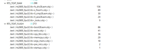

We are facing 2 issues:
  1. How do we ensure that only boot code is running directly from Flash while all other code can be run from RAM? I tried to run memcpy.c.obj from RAM, but then microcontroller fails to boot. The currect working memory allocation is shown in photo below. For our purpose memcpy should be running from RAM as we might need to use it  in ISR. This is just one example. Ideally only boot.asm should be running directly from Flash.
  2. With current settings, we cannot debug the code. Debug runs normally when we use a different linker where we load and run code from RAM only.
    Pls refer this link -https://software-dl.ti.com/ccs/esd/documents/sdto_cgt_Linker-Command-File-Primer.html
    Do you need to have memcpy.obj in Flash which has to be copied to RAM or can it be placed in RAM itself?
    In your linker command file if you have the .text section allocated on Flash and then have #pragma predefines for each function that should be in RAM, this will ensure that those functions are executing in RAM (i.e. #pragma CODE_SECTION(myFunction, ".TI.ramfunc");).
    Since you're using BINIT, you can also refer to the flash_ex3_flash_to_ram example in C2000Ware_5_01_00_00\driverlib\f2838x\examples\c28x\flash. While it is on a different device, the specific steps for doing Flash to RAM are still relevant (although the number of functions which are moved from Flash to RAM will be expanded in your case).
    This is not what I have done. Whole code I have written is in .ti.ramfunc. Only the library object files are in .text. I have handled those in linker to load from flash and run from RAM. It is not possible to assign RTS lib and driverlib code objects to .ti.ramfunc. They will go to .text section only as the lib files are pre-compiled
    I'll check this. Please refer this query to compiler team as it needs more advanced treatment.
  • Please refer this query to compiler team as it needs more advanced treatment.
    We had previously tried to have someone on the compiler team respond to this, but they have reassigned it to our group because they require more debugging first before they are willing to respond. I will try to at least narrow down the issue to something they can address before forwarding them this post a second time.
    Can you provide some detail on this? Is there an error message of some sort that shows that the device failed to boot?

  • So, as we cannot debug, we can't see what's happening. But from our LEDs, we are sure that the after the code jumps from our bootloader to this application, code gets stuck somewhere and doesn't run as it should.
    Sorry, my assumption was that you were using a debugger to run this program, is that not the case? If so, would it be possible to try and run a debug session that way you can step or at least view the Disassembly for what's happening? I will guide you further from there.
    But I suspect it could be something related to (BINIT) method. I had previously tried to use assembly code example to copy code from Flash to RAM before _c_int00 is called. But the code did not work. We cannot use the typical memcpy inside main() to copy from Flash to RAM as main() itself is part of .ti.Ramfunc and needs to be copied to RAM from Flash to be run.
    Right now, resolving the unavailability of debug is low priority issue. The more important issue is to get the whole code running from RAM
    The BINIT method should work for loading code from Flash to RAM and allowing it to execute from there before main has been called. As you correctly stated memcpy cannot do this. Unfortunately without having debug available, that makes it difficult to debug this issue. Can you check your project's map file to verify that the code or relevant functions are at least loaded to the correct Flash bank? You can find this under CPU1_FLASH or the relevant directory for your Build Configuration. Without debug we can't look to see where it gets loaded to at runtime, but we can at least see where the code is first set to.
    So, we cannot use debugger to run our code. Please note that our main application is jumped from our own bootloader, which is at Bank0, sector 0 of Flash and starts by default. I can try to Run the code directly without the bootloader, by moving it to 0x80000.
    Let me attach the current map file.

    RTS_TEXT_RAM
    *          0    0008d488    00000120     RUN ADDR = 000131a0
                      0008d488    00000088     rts2800_fpu32.lib : fs_div28.asm.obj (.text)
                      0008d510    00000059                       : s_floorf.c.obj (.text)
                      0008d569    0000001e                       : ll_cmp28.asm.obj (.text)
                      0008d587    00000018                       : ll_aox28.asm.obj (.text)
                      0008d59f    00000009                       : _lock.c.obj (.text)
