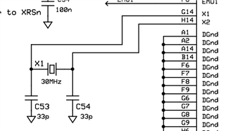

    Also, I am not seeing any Quartz in the Kit Overview, I won't be able to use an external Quartz ?
    The controlCARD has a 30MHz crystal oscillator (controlCARD Schematic).  If you wanted to use a different external clock, you would have to replace what is already installed.  This signal is not routed to the dock.
