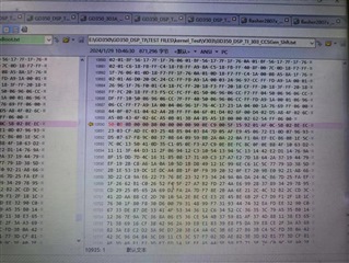

    Here's an example of divided block.
    As you can see from the picture, the first block starts with address 0x000B8000, and its length is 0x0B50.
    The second block starts with address 0x000B8B50. The memory in the first and second block is continuous since 0x000B8000 + 0x0B50 = 0x000B8B50. This txt is generated using hex2000 and we didn't specified any block length parameter. Would 0x0B50 be the default maximum block length?

  • customer is developing their own tools to convert intel hex format without boot table to ascii hex with boot table, and use it for SCI boot later.
    The utility hex2000 can take a linked executable file as input and generate a file, in ASCII hex format, with the initialized sections arranged as specified for SCI boot.  Thus, it seems you can avoid developing this custom tool.
    If that is not practical for some reason ...  The best thing is to follow the same specification hex2000 uses when arranging the initialized sections as specified for SCI boot.  Please search the TMS320F2807x Real-Time Microcontrollers Technical Reference Manual for the sub-chapter titled Boot Data Stream Structure.  There are two points that specification implies, but does not make clear.  One, the maximum size of a block is 16-bit 0xfffe words.  Two, the address of all the blocks must have the same alignment as the first block.  That alignment is 8 16-bit words (128 bits) in every case I have seen.  But other alignments are, in theory, possible.  For more motivation regarding these points, please see this forum thread.
