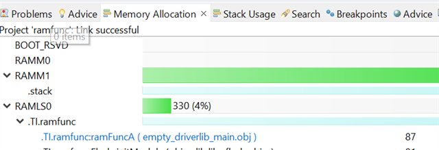

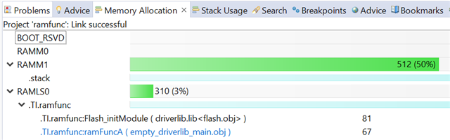

As per my understanding, there are two options for creating a function in RAM:
  1. __attribute__((ramfunc))
  2. #pragma CODE_SECTION(ramFuncA, ".TI.ramfunc")
However, both approaches result in different memory allocations.
sharing the sample for the reference
int ramFuncA(int x)
    int i = 0;
    for(i = 0; i < x; i++){}
    return x * x;
  • Using __attribute__((ramfunc)), results in a memory allocation of 87 bytes.
  • Using #pragma CODE_SECTION(ramFuncA, ".TI.ramfunc"); results in a memory allocation of 67 bytes.
Could you please explain why these two methods produce different results? I'd appreciate any insights you can provide.

  • Thanks Ki and George for the reply, sharing the details as suggested.
    5707.Logs.zip
  • Thank you for the map file and build logs.
    Both the attribute and the pragma change the default section name for the function from .text to .TI.ramfunc.  But the attribute does more.  It tells the compiler to use the fast branch instruction instead of a normal branch instruction.  A fast branch instruction is 1 word (16-bits) bigger.  For details, please search the C28x compiler manual for the sub-chapter titled Controlling Code Size Versus Speed.  Focus on the last 2 paragraphs.
