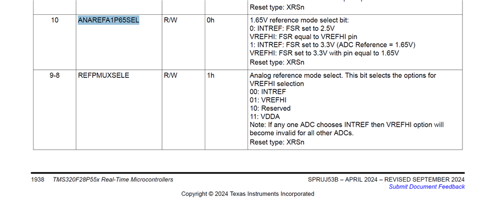

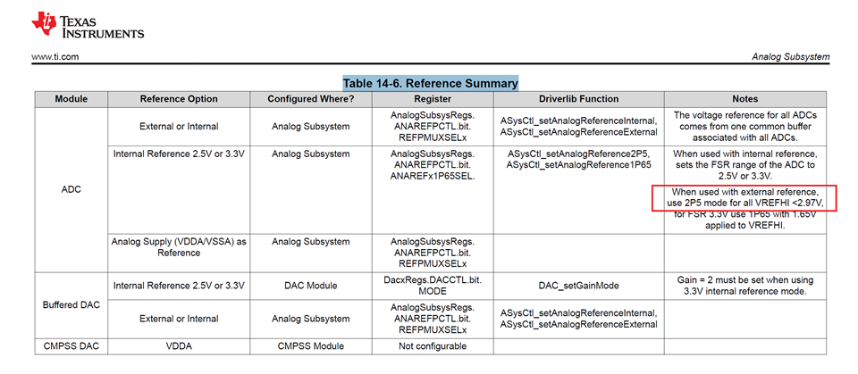

1. If the user uses 3.0V by an external ADC reference, what register/driverlib API should the user use?
In Table 14-6. Reference Summary of TRM, there is such a description, which confuses us.
Does that mean the user cannot use VREFHI = 3.0V because it seems there are only VREFHI < 2.97V and VREFHI = 1.65V?
We think the user should set ANAREFA1P65SEL = 0 and REFPMUXSELE = 1. Is it right?
