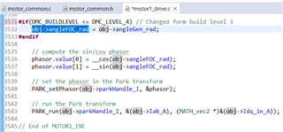

    As we know, build level 3 is open loop and here we are assigning obj->angleGen_rad (generated angle based on back emf of the motor) to obj->angleFOC_rad and based on this we are running the motor as mentioned below.
    But when I am implementing the same thing in build level 4 and istead of assigning obj->angleGen_rad to obj->angleFOC_rad, if I assign obj->angleENC_rad (Encoder angle) motor is not running. Here I replaced build level 3 with 4.
    Instead of obj->angleENC_rad if I assign obj->angleGen_rad to obj->angleFOC_rad motor is running but as I know in vehicle condition we should run our motor with encoder feedback.
    Please mention the proper way to implement the torque control mode in build level 4.

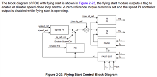

    I have read the above document but here I am unable to find out the exact information related to how to disable the speed control mode or how to enable the torque control mode.
    Please specify, which module I need to refer here regarding above issue.
    Here, it mentioned about the Flying start feature for enable or disable the speed closed loop, you are mentioning the same thing or apart from this anything we need to check?
    As I mentioned above, if I assign angleENC_rad to FOC_rad motor is not running and it is only running if I assign angleGen_rad. As I know this angleGen_rad is generated based on the back emf of the motor.
    I need to run my motor with encoder feedback in build level 4 in Torque control mode.
    Please suggest me the way to resolve this issue.

  • You can refer to the lab that can support encoder and you can enable torque control loop by disabling the speed close loop.

  • 1. Currently, motor is running in encoder based-FOC but here, once the motor crossed CTRL_RUN again, we are assigning below obj->angleGen_rad value to obj->angleFOC_rad in torque control mode. Is this proper?
    Not correct. Please refer to the Universal Motor Control Lab that can support encoder as well.
    2. Whether you are asking me to disable speed closed loop by disabling encoder sensor feedback?
    Not right. You need to use the position feedback from encoder always. As mentioned above, the Universal Motor Control Lab includes all the functions you want, you can refer to it directly.
    3. You mentioned that BUILD_LEVEL_3 is not a proper torque control mode, and it is only current closed loop, so please mention according to you what is meant by torque control mode.
    No. It's not real torque control mode. It's position open loop control with current closed-loop that is only for hardware validation
    4. Here, I commented this PI_run_series function in order to disable speed control loop, whether it is a proper way, or I need to enable this one.
    If it is not a proper method, then please specify how to disable speed closed loop?
    Just need to set the "flagEnableSpeedCtrl" to "0" in the Universal Motor Control Lab.
