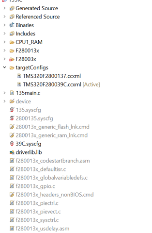

I am working on a CCS project that needs to run on both TMS320F2800135 and TMS320F280039C. To achieve this, I have included all the necessary files for both ICs and manually switch between them by:
  1. Excluding the unnecessary files (syscfg and linker command files) for the unused IC.
  2. Including the required files for the target IC.

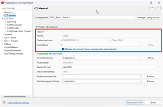

  3. Updating the target configuration in CCS by selecting the correct .ccxml file.
While switching from TMS320F2800135 to TMS320F280039C, there are no build errors, but the program does not appear to be running:
  • No output is observed.
  • The program does not seem to execute on the TMS320F280039C device.
  • Debug session runs but does not behave as expected.

  1. Checked Target Configuration:
    • Ensured that the correct .ccxml file is active in targetConfigs.
    • Verified that the correct target processor is selected.
  2. Modified Linker Command Files:
    • Excluded 2800135_generic_ram_lnk.cmd when switching to TMS320F280039C.
    • Included 280039_generic_ram_lnk.cmd instead.
  3. Checked SysConfig & DriverLib Dependencies:
    • Ensured that syscfg is updated to match the selected IC.
    • Verified that the correct driverlib files are being included in Includes.

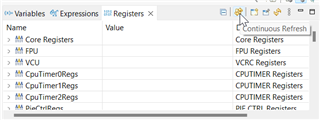

    Registers do not update in real-time unless the program is manually halted.
    Did you enable "Continuous Refresh" in the registers view?

  • Yes, I have enabled the continuous refresh in the registers view but I think the problem is occuring while transferring from 135 IC to 39C IC as even the device initialization is not happening at all which I checked by introducing the breakpoint just after the device_init() statement in the main function which is not identified by the code, and hence no data is shown in the registers as well as no GPIO is blinking in the microcontroller as well because the data is not being fed to the microcontroller. One probable reason for this can be that the sysconfig is not generating the device.c and device.h files from its own, they are added manually and from changing it from one IC to another, it's not letting me to exclude the device.c and device.h files, so that I can add these files again for new IC. I've tried reinstalling sysconfig multiple times but still it is not working, so what can be the reason for this and how to successfully migrate the project from one IC to another using two different sysconfig files.

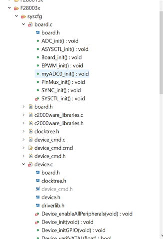

    How are you migrating SysConfig from F2800135 to F280039C? Is the "Device Support" Module enabled in SysConfig to use the generated device.c/h files?
    Matt
  • Sysconfig is not generating the device.c and device.h file from its own, so I am using the device support files within the C2000WARE sdk, so it works for the IC for which I've imported the device support files  but when I change the syconfig file and try to run it for other IC by disabling the sysconfig file of the previous IC, it doesn't and also it's not allowing me to change the device support files and so I am unable to migrate it to another IC. There's no such errors I'm facing, I just introduced a breakpoint after the device_init() function in main file which is not getting identified by the controller so it means that it is not going through the device initialization and the code is not being fed to the IC

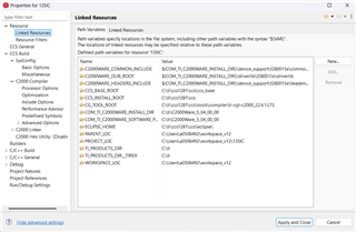

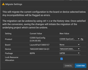

    Can you check the linker's "File Search Path in the project properties to see if the device support files are included?
    You can also try migrating the syscfg file itself -- it will migrate the configuration settings from F2800135 to F280039C automatically for you. Please note that it cannot be undone, so save a copy in case migration fails.
    1. Go to "Board View" > Switch
    2. Select the device you intend to migrate to (F280039C) and confirm the package type
    Matt

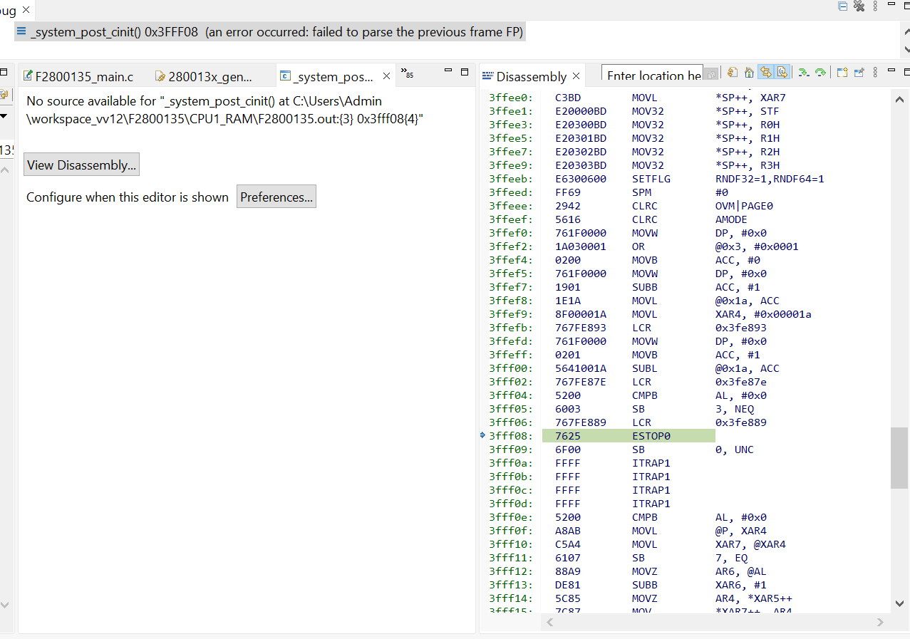

  • Okay, the device files are getting generated now, but I am getting the below debugging error while trying to debug it, can you help me with this
    The device is stuck in the ITRAP ISR. Can you try to step through the code to see what line triggers this to occur?
    Matt

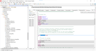

  • Just before the device_init() statement it is getting stuck and throwing this debugging error, so how to resolve this error. I've attached the registers window screenshot as well.
    Can you open Device_init() (by CTRL clicking the function) and see where it's defined? Is it from the SysConfig generated device.c or from the manually imported device.c?
    Also, are you able to Step Into Device_init()?
    Matt
  • It is from the sysconfig  as you can see the location of device.c file at the right hand side of the image. Now, how to get rid of that error
    Thank you for checking that. Can you confirm all the steps in this FAQ on migration across C2000 families are being followed? If it still doesn't work, you can send me your project to look at if possible.
    Matt
  • I've gone through the FAQ and followed each step but after converting my general project to universal. I am getting the following compilation error. So, please help me with it.

  • One last question, can you please tell me how to resolve the above error means do I have to change he driverlib file in the ccs project again for F28003x or do  I have to just add sysctl.h from the driverlib folder of F28003x or sysctl.h file needs to be generated through sysconfig. I've tried adding the sysctl.h file but still it is throwing the same error. Can you please guide me on how to ensure that the correct sysctl files are being used and so the projects can be migrated.
  • Hi Devesh,
    You will need to have two different build configurations for F28003x and F280013x devices respectively.
    • For the F28003x build version, you can include the F28003x .syscfg and exclude the F280013x .syscfg
    • For the F280013x build version, you can include the F280013x .syscfg and exclude the F28003x .syscfg
    You can create a new build configuration by right-clicking the project and navigating to Build Configurations > Manage
    Then you can include/exclude the respective syscfg files by right-clicking the intended file and selecting "Exclude from build". CCS will remember your project settings per build configuration so they won't be lost when changing between device builds.
    Matt
  • I appreciate your help and I was already looking to implement build configurations once I was done with migration, but it'll have no effect on the errors that I'm receiving because of the sysctl functions, the errors in device enable peripherals. I've tried it and still it is giving me the same error. Please guide me correctly to get rid of this error.
  • It's hard to say without diving into the specifics of the project. Is the target configuration file configured for F28003x or F280013x? Can you share the target configuration file that you are using?
    Please see this thread for more details on migrating projects: https://e2e.ti.com/support/microcontrollers/c2000-microcontrollers-group/c2000/f/c2000-microcontrollers-forum/1273438/tms320f28374s-how-to-migrate-project-from-f28379d
    Matt
  • These are the files that I've in my project folder, where I'm using  two target config file and changing them depending on which IC I'm using.
    I'm selecting the IC from build manage option, which excludes the unnecessary syscfg files from itself. It's working fine with F280013x and not giving error but on switching to F28003x, it is providing me those sysctl compilation errors
    I'm getting these errors in specific files from the board.c and device.c file generated from sysconfig as they are present in the syscfg folder. Now, please give me some valuable suggestion from which I can use my project for F28003x IC as well just by using migration.
    It looks like the device support header files for F28003x aren't being included in the build.
    Two things to check:
    1. What does the project's "Includes" folder look like after building the F28003x configuration?
    2. Please go to Project Properties > CCS General > Project. What does that menu show?
    You can also try manually linking the necessary device support header files, they're located at: C2000Ware_5_04_00_00\device_support\f28003x\headers
    Matt
  • I've already tried including the device support files manually, it still shows the same error
    Now, is there any way to resolve this problem and to get rid of the compilation error of sysctl and device_init().

  • Hi Devesh,
    I got the project to successfully build for 39C and 135 by doing the following:
    1. In the project's Properties > Resource > Linked Resources, I changed the following path variables for "f28003x" or "f280013x" respectively. Note that these settings stay the same between build configurations, so you'll have to change it each time you build the project for F28003x and F280013x.
      1. C2000WARE_COMMON_INCLUDE
      2. C2000WARE_DLIB_ROOT
      3. C2000WARE_HEADERS_INCLUDE
    2. I deleted the other build configuration folder before compiling. For example, if I'm building for F28003x, I deleted the "F280013x" folder in the project. These folders are generated by the build and conflict with each other.
    3. Lastly, I noticed that your F28003x project doesn't map properly with the current linker command file settings. I recommend you use the generic RAM linker command file.
    Matt
