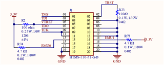

I am trying to program 28379D IC mounted on customized design board through external XDS110 debugger. It could flash the program for the first time when I started, but after that it is showing "loading error" whenever I am trying. I am using a recommended design circuit for the jtag which I have already used in other board. But I am not able to program this new board. I am attaching the jtag connection diagram
Boot mode selection is kept 1,1 always. TRST pulled down by 10k. All signals are coming fine..I tried following things as fix which didnt work
1. Changing the TRST pull down resistor to 2.2k
2. Selection CPU1 core, while disabling CPU2 core
3. My power supplies are capable enough to deliver the current during flash (checked)
Please suggest what could be done next. Also, if its a hardware related error, then how come it worked for the first time.

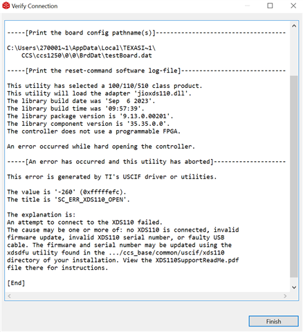

    Can you share a screenshot of the exact loading error message? Is the JTAG able to successfully connect to the device?

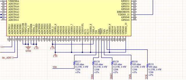

    I have a custom designed board with 28379D and external xds110 debugger.
    Here is the connection for JTag. I am operating in wait mode. But the Jtag connection is not getting established. I have an exact identical board where its working absolutely fine. But for this board I am getting following error
    I checked following things
    1. Both 3.3, 1.2V are coming fine
    2. Reduced the TCLK to 100kHz
    3. Change the boot settings
    4. Change the TRST  pull down resistor from 2.2k to 10k
    5. No short in in 3.3 or 1.2V in the board
    ** Initially it detected the JTag for the first time. But after debugging code for one time its giving same error

    1. How far away is the board from the debugger?
    2. Did you monitor XRSn to confirm it goes high during boot up?
    3. Are TDI and TDO being used as GPIOs at runtime?

    This is happening when I am trying to see the jtag connection from build settings and its not flashing, showing the following error

    3. Are TDI and TDO being used as GPIOs at runtime?- I am not using TDI, TDO as GPIOs

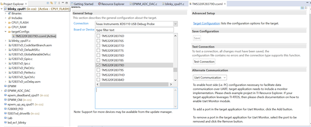

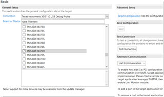

    3. Can you share you target configuration file (.ccxml)?
    Matt
    1. Yes. This happens when I am trying to flash a program. Also, I checked the Jtag connectivity with "test connection" tab, there only I got this error msg
    2. Yes. Wait boot is configured
    3.
