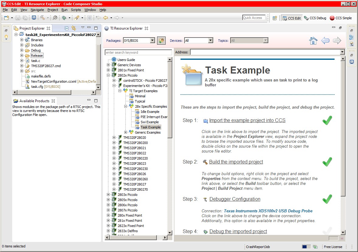

  • Is anybody watching  this thread anymore?  I have the same problem, and just "copy this" doesn't explain what is going on.
    Honestly, nothing is documented to solve this issue, and I have spent 5 days trying to reverse engineer what is going on.  NONE of it makes sense...
    Steps to reproduce:
    1. Take a brand new LauchXL board, plug it in.  It runs the internal demo program. (the demo is in flash, obviously)
    2. Load the "Experimenters kit TASK 28" from control suite (no, I'm not uploading my project files, they are in control suite, which everyone has access to)
    3. Build and load the program, watch it run.
    4. Stop the debug task, unplug the board.
    5. Plug the board back in, it's dead. NO CODE IS RUNNING.
    6. Obtain the original demo code "Example F2802xLaunchPadDemo" and rebuild it, and reload it. Watch it run.
    7. Unplug the board, just like the above step 5. Plug it back in, and the demo program runs.
    WHY DOES THE DEMO PROGRAM PERSIST, BUT THE SAMPLE "TASK 28" DOESN'T?  The map file of "Experimenters kit TASK 28" shows that every function is stored in flash.  I see why... the entry point is pointing to the wrong place...  but wait.
    I see that the  "Example F2802xLaunchPadDemo" gives a build warning:
         entry-point symbol other than "_c_int00" specified:  "code_start"
    I DARE anyone to find where "code_start" is specified anywhere in the project!  But the build process is complaining about it!!  And the map file shows that this address is correctly set to 0x003f7ff6   (the boot rom final target)... I have no idea where is came from, how it got set there, what setting in what file told it to do that...
    On the other hand, the "Experimenters kit TASK 28" project imported and unchanged from the control Suite shows that the entry point "_c_int00"  is set to address: 0x003f14fe .   Where did it pull that from???  There is no place to specify that anywhere I can find in the settings, in the documentation, in anything!
    So, if  "code_start" isn't specified anywhere in the "Demo", how can I imagine to try to copy the setting to the "Task 28" project , and change the name to "_c_int00" ??
    Why doesn't the "Task 28" project properly set this out of the box?
    Why does the "Task 28" project even work if it's NOT setting the entry point to the BOOT ROM target of 0x003f7ff6 ?  How can that even happen?
    The Piccolo Boot Rom guide (sprufn6a) explains the boot ROM flow.  But not this issue.  The Assembly and Linker tools document (spru513L) has a bunch of  directives to put in the "cmd" file, but I can't get any of it to make sense.  It doesn't match what I'm seeing in the example projects.
    I am using CCS 6.2, and the newest of everything.  Installed less than 2 weeks ago, and I've gotten to spend those two weeks trying to figure out why this doesn't work.
    Getting more frustrated day by day...  I've been coding Micro Chip PIC devices for 18 years.  I know the concepts.  However, I can't seem to figure out this world.
    -CSW

  • Santosh,
    No. I cannot provide the path to that example, because the CCS design insists on hiding all that information.  I have absolutely NO CLUE where the CCS Resource Explorer found this thing.  I have attached the screen shot of what I selected.
    When I load it from CCS, it runs.  When I try to just run it by powering up the board, it doesn't.  (I have since then added the "boot.asm" file, and now it works)
    As for your information, it is not correct.  I am already linking to "driverlib.lib" in that "task28_experimenterkit_piccolo...", and it is NOT providing an entry point called "codestart".  On the other hand, the "Example F2802xLaunchPadDemo" has "driverlib.lib" listed in the project (linked file).  So both projects use that file, although different versions.
    The linker cmd file is already directing ALL the code into flash.  And the boot ROM is directing the entry point to a location in FLASH.  But there is no way to make "_c_int00" be assigned to that entry point address.
    Instead, I imported the ASM code to define that point.  Now it does what it is supposed to.  Would have been nice if that was explained somewhere. Or documented somewhere.  Or just *something* that didn't take 5 days of wasting time trying to figure this out.
    Is the BOOT ROM inside the TMS320F28027 always burned this way, or is it ONLY in the chips are are on the Piccolo launchpad devices?  If we bought a hundred chips, would they have this ROM burned, or would it be blank and we have to code it ourselves?
    It would also be nice if my CCS wasn't constantly crashing. I keep getting "Just In Time" debugger messages from the visual studio wanting to debug "cef_sub_process.exe" which is owned by CCS.
  • To anyone else who has this problem, it is because the BOOT ROM in the Piccolo board is trying to execute the memory location 0x003f7ff6 as the entry point to the compiled program... But there is no way to set the C compiler to designate "_c_int00" to that location.
    It would appear that "_c_int00" is not actually a "label" to a location.
    The solution is to add the following small assembler code to your project. Name this "boot.asm" or similar. This has a real label named "codestart", and it is a simple jump to the location "_c_int00". (You do NOT want to jump to "main" because the C program has to set up stuff before main can run, like initializing variables in ram).
