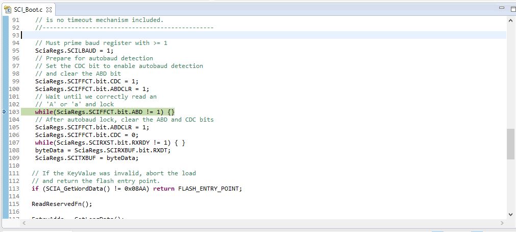

    But my boot loading is waiting in following line of SCI_BOOT.c
    where he is waiting for some character and then it will echo back the same character.
    Now i opened Realterm for testing echoing of sent character.But when i am sending 'A' , i am not receiving 'A' character echoed back.And neither i am able to bootload my application code through sci interface to the MCU.

    Based on your snapshot, it is clear that you are able to enter SCI_Boot successfully.
    You haven't provided any details about how you have connected F28035 to host? Is your PC acting as host? (or) someother memory device with SCI protocol acting as host? Did you make sure host signals are being received by the device using oscilloscope?

  • Hi all,
    I have probed Rx line of MCU. So in that i am correctly seeing that 'A(1010)' is being transmitted by my Serial --> USB converter to my MCU(Tms320f28035).
    But my MCU is still not able to recognize that character and thus not able to receive echo back the same character.
    So problem is my autobaud lock is not getting unlocked due to which my code is stucking at that point.Please help me in resolving this issue
    Thanks.
    Siddharth
  • Sidharth,
    what is the baud rate you are using, can you try 9600 baud? Try couple of baud rate options. Also the ROM loader expects 0x08AA as key after baud rate lock, so I would suggest you to add a break point in the code after ABD check, you might be missing it as well because the laoder doesn't get 0x08AA and it is trying to boot to flash and nothing is in flash and device resets?

  • Hi Santosh sir,
    I was earlier using TMS320F28035 Isolated controlCARD(www.ti.com/.../tmdscncd28035iso) for my development purposes.But in that autobaud lock is not unlocking,even i have used 9600 baud rate.And thus it is not replying back with 'a' or 'A'.
    So then after much debugging,i started trying with TMS3320f28027 and in that everything works perfectly. Then,I have also tried same things with different TMS320F28035 Isolated controlCARD and in that also it is working fine.So i am doubting my earlier f28035 hardware for this problem.
    So now my code is flashing correctly on RAM.But currently i am using factory programmed boot loader of MCU for doing so.
