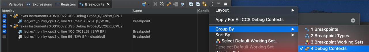

Hi everybody ,
I am setting  one breakpoint inside one interrupt, and another breakpoint inside another interrupt, In CPU2. The first breakpoint pauses the program and so ok, but the second breakpoint is not pausing the program. These two breakpoints belong to the different interrupts of the same file. both on CPU2
The same steps followed in CPU1, does not have any problem.
I do not believe it is related to the action of code, because, it does enter sometimes when used CCS10, while does not enter using CCS7.
This problem is only in the debug mode.
I tried also to  set breakpoints in differnet lines of code , but no way on CPU2  issue is there
what can I test /do  to solve this ?
thank you
BR
Carlo

    Another thing to check if the same code is being used on both cores is to make sure that the breakpoint is being set on the correct context.  If debugging a multicore device I like to setup the breakpoint view to group breakpoints by "debug context".  This can be done by clicking on the 3 virtical dots in the breakpoints view and selecting Group By -> debug context.
    John
